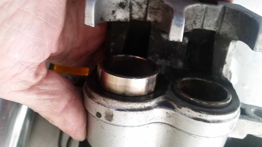

Lug Nut Posted September 13, 2016 Author Posted September 13, 2016 (edited) I took off the master cylinder just now...huge Dent in the Piston when the bike fell over and broke the brake lever.....I'm assuming damage to the spring or rubber inside. . New Yamaha rebuild kit ordered. http://i429.photobucket.com/albums/qq14/sbojrab/Mobile%20Uploads/20160912_200811_zpss00hnecu.jpg Edited September 13, 2016 by Lug Nut
