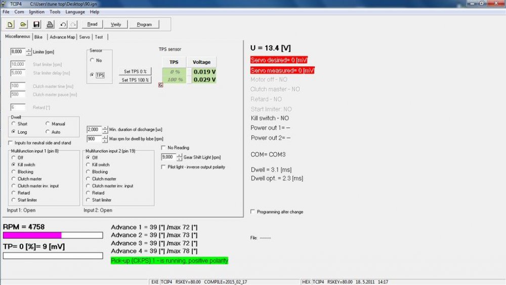

Black wing Posted August 3, 2016 Author Posted August 3, 2016 (edited) yeah its got the map sensor on it but im not getting a read from it when its running EDIT: so while watching the tps i figured out where the reading issue is. the voltage reads back wards to a real tps. so closed throttle is .019v and full is .009, but the v80 software wont let me set a smaller value as the 100% 0% 100% Edited August 3, 2016 by Black wing

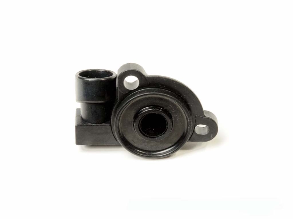

Black wing Posted August 3, 2016 Author Posted August 3, 2016 (edited) now that is a good idea, i guess i'll head to the parts shop tomorrow. any idea which tps works best with this system? EDIT: this one looks like i could mount it directly to the carb rack http://www.highwaystars.net/sensor-throttle-position-acdelco/ Edited August 3, 2016 by Black wing
