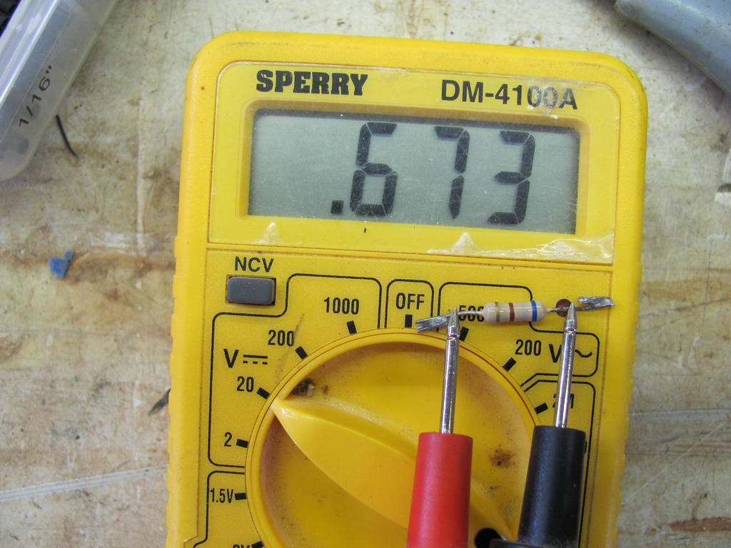

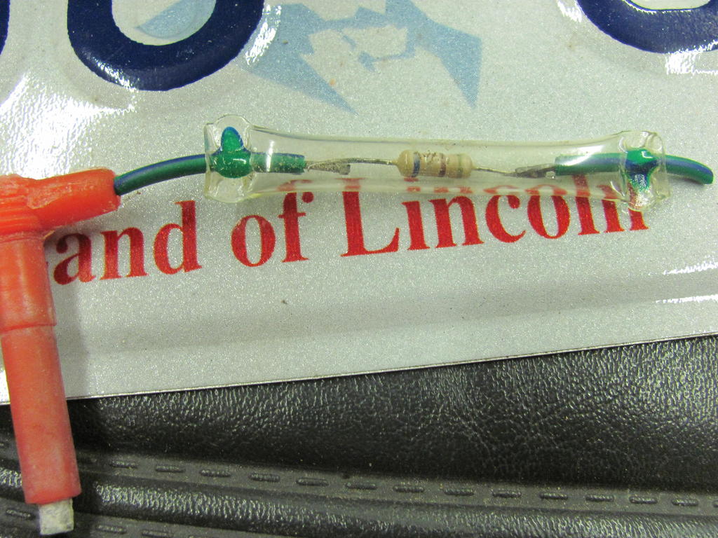

Prairiehammer Posted August 4, 2016 #8 Posted August 4, 2016 (edited) Freebird said: I still don't know what resistor you are talking about being soldered to the accessory fuse holder. The stock wiring for the battery electrolyte sensor circuit included a resistor. The resistor value was quite low, too low to allow a direct connection to 12 volts. There is no danger in adding the 2-4K resistor in series with the existing stock resistor. Edited August 4, 2016 by Prairiehammer
