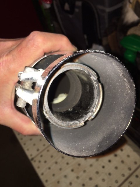

Freebird Posted May 8, 2016 Posted May 8, 2016 All the stock mufflers I've seen have gaskets. They are very thin and usually stay inside the muffler. About, I don't know, maybe 3" long and something like 1/16" thick...like a tube. Most of the aftermarket mufflers and/or Harley mufflers that people use do NOT have the gaskets. It has been my experience that if you put the stock mufflers on without gaskets, they will not tighten up properly.
Freebird Posted May 8, 2016 Posted May 8, 2016 Here's a picture that I just took of the stock muffler with gasket.
Mad Dog Posted May 8, 2016 Author Posted May 8, 2016 All the stock mufflers I've seen have gaskets. They are very thin and usually stay inside the muffler. About, I don't know, maybe 3" long and something like 1/16" thick...like a tube. Most of the aftermarket mufflers and/or Harley mufflers that people use do NOT have the gaskets. It has been my experience that if you put the stock mufflers on without gaskets, they will not tighten up properly. Hmmmm ... if they are that thin maybe I missed them. I was not too sure what I was looking for, and didn't expect something that thin.
MikeWa Posted May 8, 2016 Posted May 8, 2016 The gasket is actually a very fine woven mesh. If it should stuck to the pipe and the muffler pulling things apart can be very difficult. I had one where the gasket stretched out to over two feet long. A thorough pain to get off. So when you put the muffler back on coat the inside of the gasket with some anti-seize. Just saying. Mike Oh and if the gasket wasn't in place the muffler would have been very loose.
Mad Dog Posted May 8, 2016 Author Posted May 8, 2016 I think the gaskets are there... they are pushed into the mufflers an inch or so. Pretty sure thats what I'm looking at. The mufflers certainly weren't loose!
