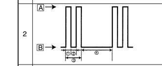

  19. Interesting, thank you. I saw the flashes and looked them up in the book, but maybe they weren't indicating what I thought. I'm going to step through everything. Here's what I saw originally: The flash pattern and the fault code. I'll check back in after I try the troubleshooting you suggest. Thanks again.

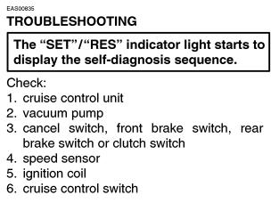

  20. So my Cruise control isn't working. This is new, it was pretty reliable before. Now, the "On" light comes on but then nothing, no other lights etc. I do the the 2 quick flashes with the break repeating ... so that says vacuum pump. I am asking if anyone has any experience with this? Is it 100% the vac pump before I start taking the faring off? Is there anything else I should try and kick or hit with a hammer or something?? I see one for $17 on Ebay, so maybe I should just grab that... not sure. Any input will help. thanks Mike
