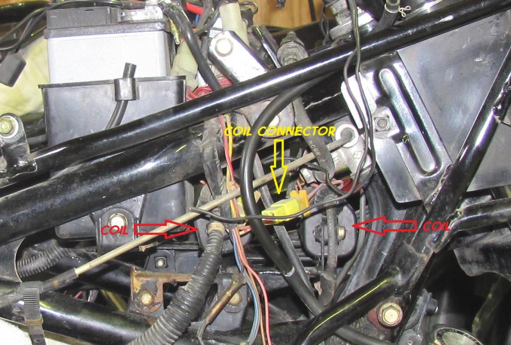

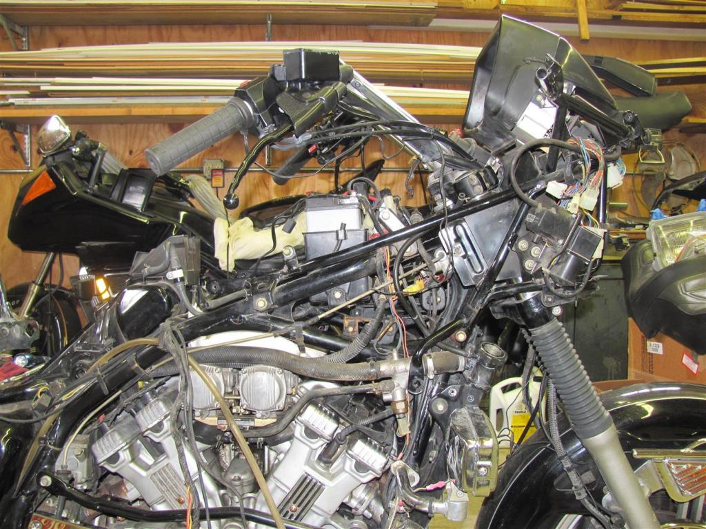

Prairiehammer Posted February 23, 2016 #3 Posted February 23, 2016 Getting to the ignition coil connectors is fairly difficult. One may remove the main fairing(s) and the inner fairing(s) to gain access to the coils and their connectors. Or one may remove the battery box/holder. Removing the battery box usually requires inner fairing removal, however. One MAY be able to access the connectors from the top, in front of the battery, but I suspect not. There is a lot of electrical bundles, fuse block, etc in the way. Check out this pic of my Venture with all fairings and plastic removed, revealing the coils and the coil connectors. Notice what has to be removed to access the connectors?
camos Posted February 24, 2016 Author #4 Posted February 24, 2016 Prairiehammer said: Getting to the ignition coil connectors is fairly difficult. One may remove the main fairing(s) and the inner fairing(s) to gain access to the coils and their connectors. Or one may remove the battery box/holder. Removing the battery box usually requires inner fairing removal, however. One MAY be able to access the connectors from the top, in front of the battery, but I suspect not. There is a lot of electrical bundles, fuse block, etc in the way. Check out this pic of my Venture with all fairings and plastic removed, revealing the coils and the coil connectors. Notice what has to be removed to access the connectors?Holy smokes!!! I'll take your word that the coils can be seen in that pic but I haven't found them yet. I know the TCI and it's connector can be seen after removing the air box. I was expecting the coils to be attached to that plug but was not sure if there were any connectors in between. In any case, it looks like I will probably need a couple of free days before getting into that job. sigh.... Thanks Kevin, it's not what I wanted to hear but helpful all the same.

Prairiehammer Posted February 24, 2016 #6 Posted February 24, 2016 camos said: Holy smokes!!! I'll take your word that the coils can be seen in that pic but I haven't found them yet. Here is a pic of the coils and connectors:
camos Posted February 24, 2016 Author #7 Posted February 24, 2016 Prairiehammer said: Here is a pic of the coils and connectors:No wonder I couldn't see them, they were dead centre in front of my face. Not to mention in perhaps the most difficult place to get to on the bike. Thanks again... very helpful.
