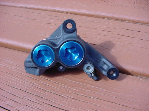

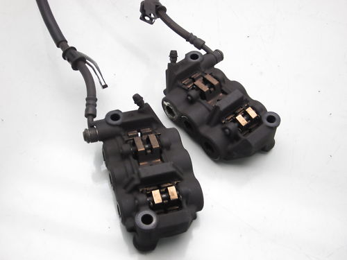

Condor Posted November 9, 2015 #4 Posted November 9, 2015 Started to answer this thread yesterday, but got called away mid-answer, and when I came back I couldn't find it because they don't keep the thing after you've looked at it. Anyway.... R1 and R6 plus FJR's will fit. Blue or gold dot. Here's a couple of pics of the type you want to buy. The first will fit, the second will not work.
