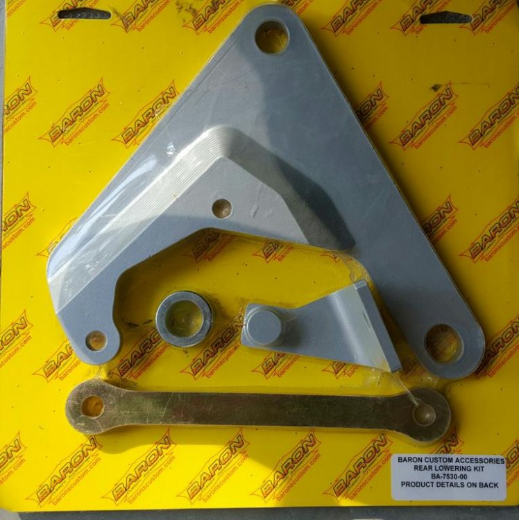

stevernc Posted October 28, 2015 Posted October 28, 2015 Hello, I am planning on installing the Barons Lowering kit (BA-7530-00) on my 2000 Venture. I'm not a mechanic but have worked a lot on my bike (ie. replacing the clutch, tires, etc.), from YouTube videos, etc. The instructions from Barons are terrible. I even called them and they basically said what you see is what you get and couldn't help me. I'm a "visual" person. If I can see pics/video of the install then there's no problem with me doing the installation. Does anyone have any pics or video of this install. I cant find anything on the internet concerning this for a Venture. Any help would be greatly appreciated. Thanks

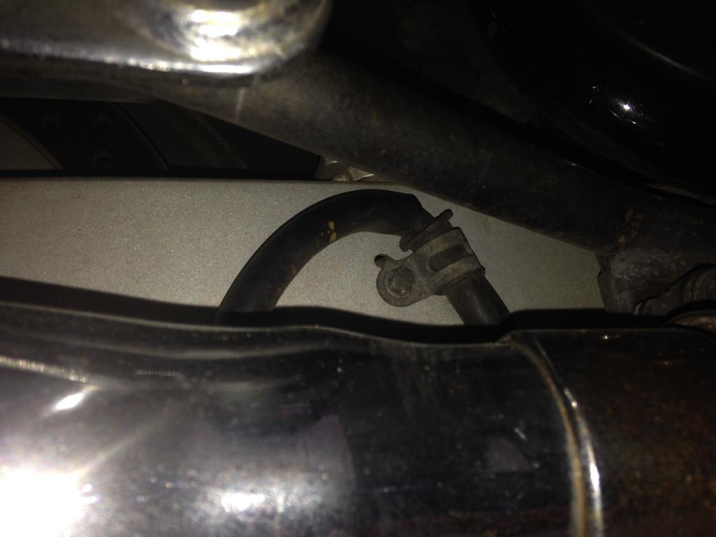

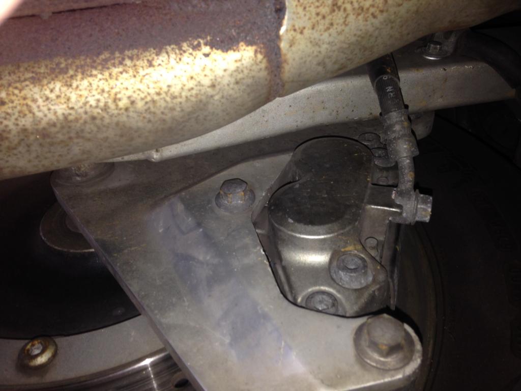

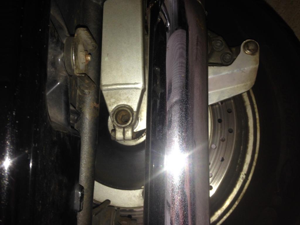

Mike G in SC Posted October 28, 2015 Posted October 28, 2015 (edited) Hey Steve, (and Steve A) And,,, I'm not a mechanic either. But I did manage to look busy when a mechanic friend installed one on my RSV. Obviously jack it up. He tied the front down in his trailer chock then jacked under the engine to raise the rear. Else if you got a MC jack. Pulled the saddle bags. Pulled the mufflers (right for sure, probably left also). Pulled the caliper and the clamp bracket on the brake line, and hang it from the swingarm or frame with a wire (coat hanger). And he did have to remove the axle because it goes through the mount. See Pic. Don't think he actually pulled the wheel. (Maybe you can get away with leaving the caliper on the rotor and just rotate the tire to line it up to the Barons brace(???). Put the bracket on the axle, push the axle through and can tighten it back. To be honest, I don't remember at what point he mounted the caliper to the Barons brace. You will figure that out. His hardest part was moving the caliper down where it needs to go and putting the brake line clamp back on the swing arm took some work to get the new bend angle on the brake line and get the clamp mounted in the hole in the swing arm. But you can see, he did. Good time to look at your rear pads. But the nice thing about this kit is that you can now inspect or change the rear pads anytime without pulling the saddle bag. Okay, disclaimer time. These are pics from my RSTD which has rusty Barons 4-2-4. Hey, this is a go-bike not a sho-bike,,, with 103K miles. So,,,, read this,,, look at the pictures,,, turn your head sideways on one. And then,, call friend Steve A JR (above post) and see if he can help. (Hey Steve,,, see you in about 10 days for the Vet Parade) Mike G in SC Edited October 28, 2015 by Mike G in SC

Mike G in SC Posted October 28, 2015 Posted October 28, 2015 (edited) Stevernc, sorry I was busy editing my post. Also, Steve A,, got confused which Steve was which. Define connecting arms. Do you mean the dog bones? If I can get a pic without pulling the pipes I will. Mike G I'm going to edit this post for discussion on the dog bones (links). The links are a separate install from installing the caliper relocation bracket. So, I would do the caliper relocation first. But leave the saddle bags and mufflers off. Then, the links are pretty easy. I did not see it looking different enough to warrant a picture. Looks same but longer. You raise the rear of the bike just to take weight off the wheel. Not in the air. You have two bolts, a top and bottom. Loosen them (pull the nuts). Pull the two bolts. These bolts are through sleeves (or at least one is). They could be tough to get out, may have to tap them out from the end. (Good time to clean and lube the sleeves before you put them back.) Then install the two Barons links. Yes they are longer than the stock (have to think about that logic, longer links to shorten your ride!!) You will need to jack the bike about 1/2 inch to get them to fit. When you put the nuts back on, careful, they can crush. So, don't try to hunker down on them or you will find they are expensive. Something worth doing may be to put a stock link and a Barons link on a piece of paper or cardboard. Trace outline them and their holes. I did this to later go to a fab shop and have him make a set half way in between. So, then I was able to raise my bike back to 3/4" in stead of the full 1 1/2",,, which I was more than I wanted. Rule of thumb,, for each 1/4" difference in the center holes of the links, you get 1" on the bike. The Rivco leveling links for the tall guys is actually about 1/4" SHORTER than the stock links. Go figure. Mike G. PS,, remember to put your mufflers and saddle bags back on. Only said that because you are in NC. lol Edited October 28, 2015 by Mike G in SC
