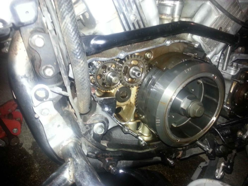

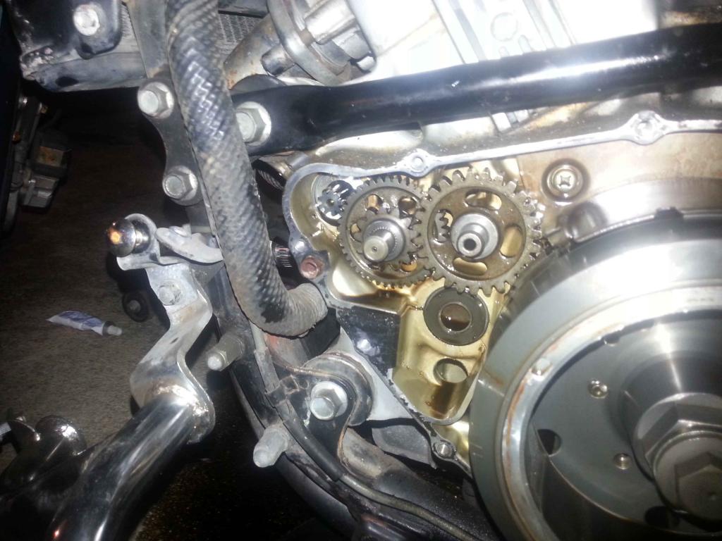

mralex714 Posted October 15, 2015 Author #6 Posted October 15, 2015 I pulled the cover to take a look. Gears fell out when I took off the cover. I put them back on in the configuration you see. Is there anything other than the cover holding the gears in place?
Flyinfool Posted October 15, 2015 #7 Posted October 15, 2015 From the pics I do not see anything wrong. As long as you are in there, turn the 72 tooth gear by hand it should only turn one way. When you put the cover back on, you MUST have a gasket or the gears WILL bind.
mralex714 Posted October 16, 2015 Author #8 Posted October 16, 2015 Flyinfool said: From the pics I do not see anything wrong. As long as you are in there, turn the 72 tooth gear by hand it should only turn one way. When you put the cover back on, you MUST have a gasket or the gears WILL bind. I took the gears back off to spin the 72 tooth gear, turned freely in only one direction ,clockwise. This afternoon I hit the starter with the cover still off and everything worked as advertised. Before I put this thing back together I need to know what went wrong or is there something else I need to do before reassembly. I ask this also because the gaskets looked fairly new and maybe the PO had an issue or left something out.

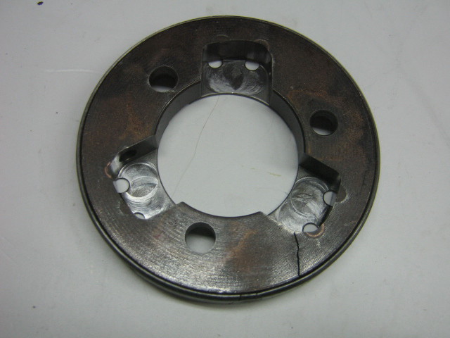

Prairiehammer Posted October 27, 2015 #10 Posted October 27, 2015 Prairiehammer said: It is possible also that the starter clutch (sprag) is seized in the freewheel position. mralex714 said: I am back to square one. I went to start the bike today and got nothing but the sound of a spinning starter with no engine rotation. Any other thoughts on what might be happening or what else I need to look at? I suspect there is a fault in the starter clutch. Either broken springs, rusty and sticky rollers or worn/damaged clutch face on the 72 tooth gear (where the starter clutch 'sprag' engages) or cracked starter clutch, causing a failure to engage.
mralex714 Posted October 28, 2015 Author #11 Posted October 28, 2015 Prairiehammer said: I suspect there is a fault in the starter clutch. Either broken springs, rusty and sticky rollers or worn/damaged clutch face on the 72 tooth gear (where the starter clutch 'sprag' engages) or cracked starter clutch, causing a failure to engage. [ATTACH=CONFIG]102154[/ATTACH] Since I didn't have the usual noise with a bad starter clutch I thought maybe I would be spared this task.
garyS-NJ Posted October 30, 2015 #12 Posted October 30, 2015 I was helping a friend with his '86 or 87 venture and had a starter issue where the starter would spin and squeal but only sometime engage the engine to turn the engine.. We took that cover off figuring we'd see something (I was guessing the flywheel key sheared) but nothing jumped out.. We even cranked the starter cover off while stabilizing the starter idler gear shafts. I gave him an old starter to try but suspect the starter clutch,.
mralex714 Posted November 1, 2015 Author #13 Posted November 1, 2015 Prairiehammer said: I suspect there is a fault in the starter clutch. Either broken springs, rusty and sticky rollers or worn/damaged clutch face on the 72 tooth gear (where the starter clutch 'sprag' engages) or cracked starter clutch, causing a failure to engage. [ATTACH=CONFIG]102154[/ATTACH] So I need the starter clutch and the 72 tooth gear?
