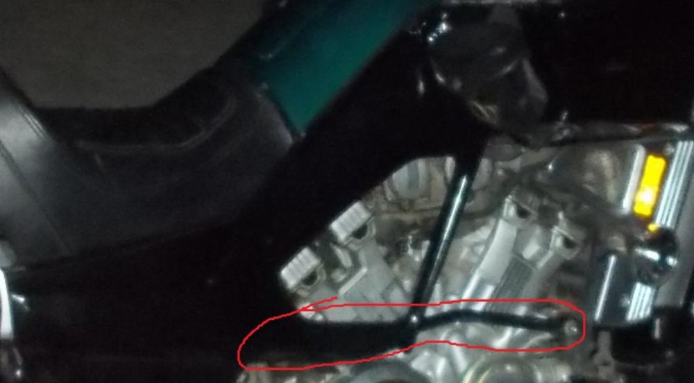

VerntureVet Posted September 10, 2015 #1 Posted September 10, 2015 Ok so I have found more than one bike project that has removed this. I am leery to remove anything that could be there for a reason. Is this thing needed or was it just there for the side panels?
ChurchBuilder Posted September 10, 2015 #2 Posted September 10, 2015 I left mine loose one time and I noticed the frame was more flexible than normal.
Great White Posted September 10, 2015 #3 Posted September 10, 2015 Depends on your definition of "needed". Chassis is pretty loose as delivered. Removing the cross brace will just make it more so but it's not like the bike is going to fold in half or spit you off at the first corner. The VMax boys often add a brace in pretty much the same spot. Their backbone is also a little bit different. IIRC, spread open a bit more do to the added height of the VBoost system. Personally, I'd leave it in place. But I also push the chassis pretty hard most days.....
VerntureVet Posted September 10, 2015 Author #4 Posted September 10, 2015 Great White said: Depends on your definition of "needed". Chassis is pretty loose as delivered. Removing the cross brace will just make it more so but it's not like the bike is going to fold in half or spit you off at the first corner. The VMax boys often add a brace in pretty much the same spot. Their backbone is also a little bit different. IIRC, spread open a bit more do to the added height of the VBoost system. Personally, I'd leave it in place. But I also push the chassis pretty hard most days..... To me with what I am doing its just looks out of place. Maybe I will take it off and if I don't like the way ot handles I will put it back on after wrapping it in copper like I will be doing to the other frame parts. that you both for the feedback.
Prairiehammer Posted September 10, 2015 #5 Posted September 10, 2015 Yamaha calls it a "stay" as in lower fairing stay, IOW it is just a place to keep the lower fairing in a semi permanent location. If you notice, the aft end of that stay is attached to the frame with a fairly small bolt AND that bolt goes through an elongated hole in the stay. There is no way that arrangement can offer much to the frame rigidity. It is just a stay for the lowers.

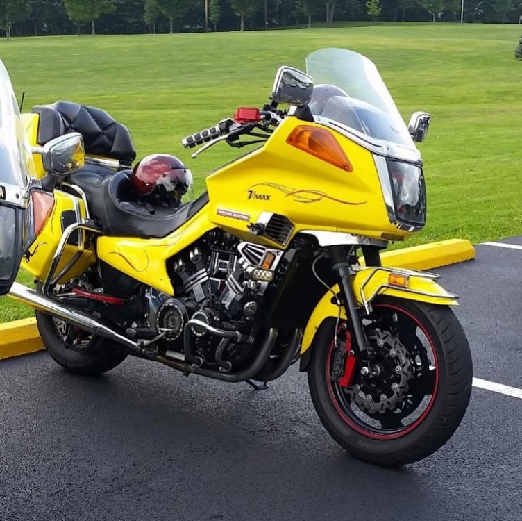

dingy Posted September 11, 2015 #7 Posted September 11, 2015 You do not need them. I have a fair amount of horsepower & have a VMax (FJR actually) and a 15" rim on rear, both help low end acceleration. I don't notice anything out of the ordinary. I have pushed this scooter fairly hard in turns and it is stable. The braces (stays) were removed to allow bikini cut on side covers to expose the motor. Braces looked crappy crossing the heads with cut side covers. I cut brace off and left about 4" on back side to secure side covers. You might be able to see head of screw at bottom front point of side cover in picture. It retains a zip tie fastener that slips over the studded of ends of braces to hold covers secure. Gary
