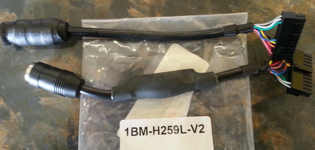

Du-Rron Posted May 29, 2015 Posted May 29, 2015 With the recent rains and a new work schedule I have been riding the bike less. If I let it set for 6 days, the battery is flat and she will not crank. Audio Fuse powers radio memory, odometer memory, and ISimple unit when key is off. Key Off Draw was 220ma. Unplug ISimple unit and KOD went to 16ma. Dealer ordered another cable from DIN connector to ISimple unit. This is Version II of this cable. It has something in the middle of it. If battery voltage drops below 12.6 it is supposed to cut power to ISimple memory. (So the story goes). The original factory cable is on top. The V2 of the cable is on bottom. If your battery is flat after about six days with ISimple connected but will stay charged with ISimple disconnected, might want your dealer to look into Key Off Draw and explore getting a new ISimple power cable.

Du-Rron Posted June 14, 2015 Author Posted June 14, 2015 Update: Recent rains have let the bike sit in the garage for 6 days. Before I attempted a start I measured the battery. It showed 12.72 volts. Almost a perfect charge. Put the key in and she started right up. I believe V2 of the Isimple cable has solved the flat battery problem.

Du-Rron Posted July 17, 2015 Author Posted July 17, 2015 Did they give the part under warranty? if so do you know the service bulletin or recall on it please Part was replaced under warranty. There was no svc bul or recall on it. Yamaha knows about it though, that's why v2 of the cable exists.
