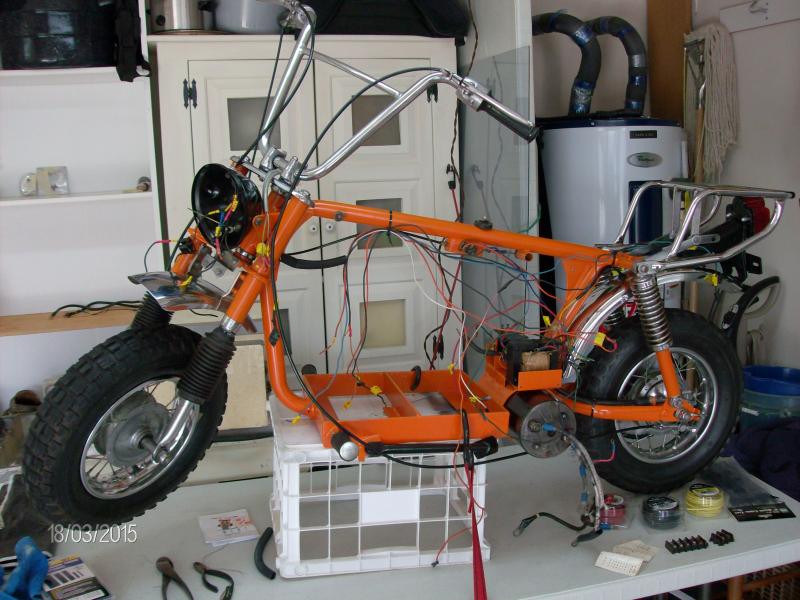

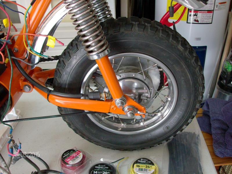

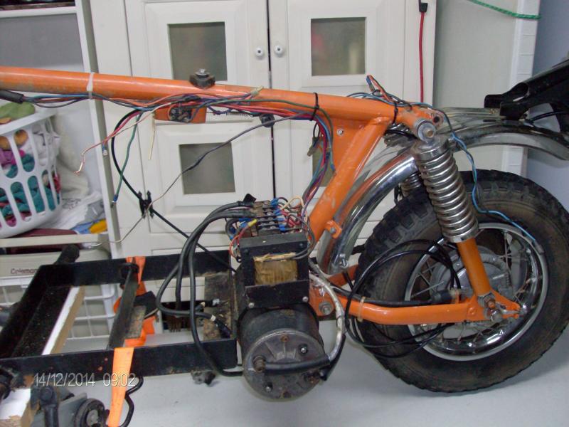

Eck Posted March 20, 2015 Author Posted March 20, 2015 I have been out of the aircraft maintenance field since 96. Been employed in the racing world since then, well up to Dec31 2014. Now I have to find something else to do. I started restoring a fully electric mini bike.. Auranthetic Charger is what it is called.. I am not sending out the chrome parts to be re-chromed.. but other than that it is 100% torn down and I am in the process now of getting it back together. Frame and parts have all been repainted except for the "fake" gas tank. I will paint it in about three weeks from now. Started re-assembly 03-18-15 but I am working at a slow pace on purpose to do it right. It gives me something to do on rainy days!! Here are a few pics of before and after. In the first couple pics you can see how the battery acid tore up the paint job.. The last two pics (pic-1838 and pic-1839) are pics of the re-assembly going on after fresh paint. Man, did I hi-jack my own thread or what here....ha

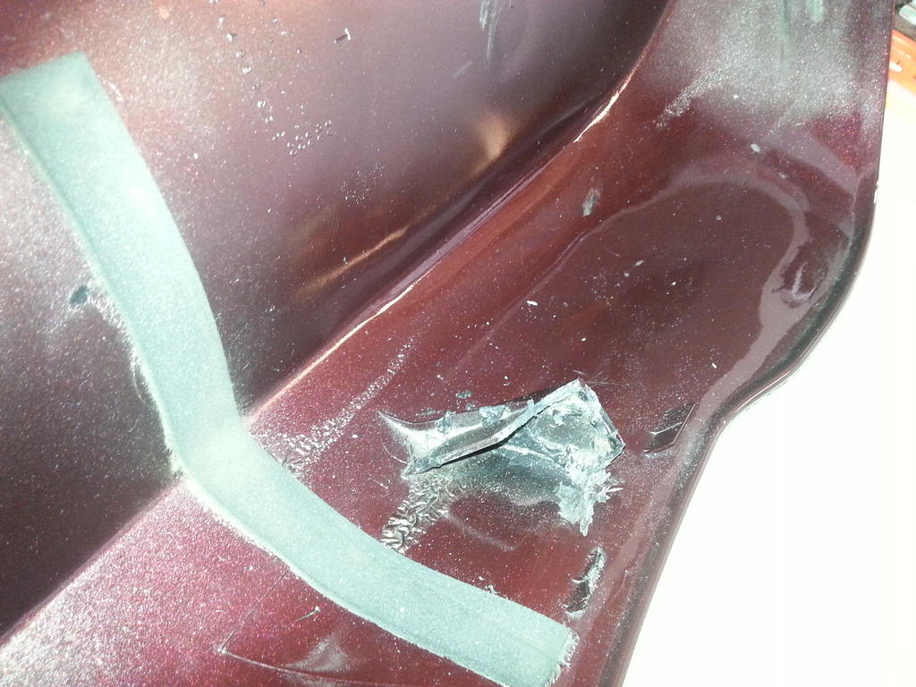

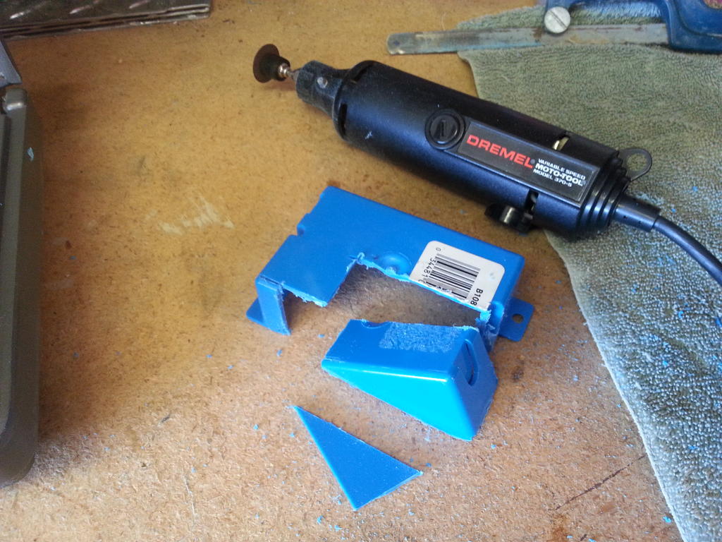

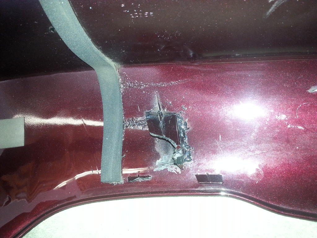

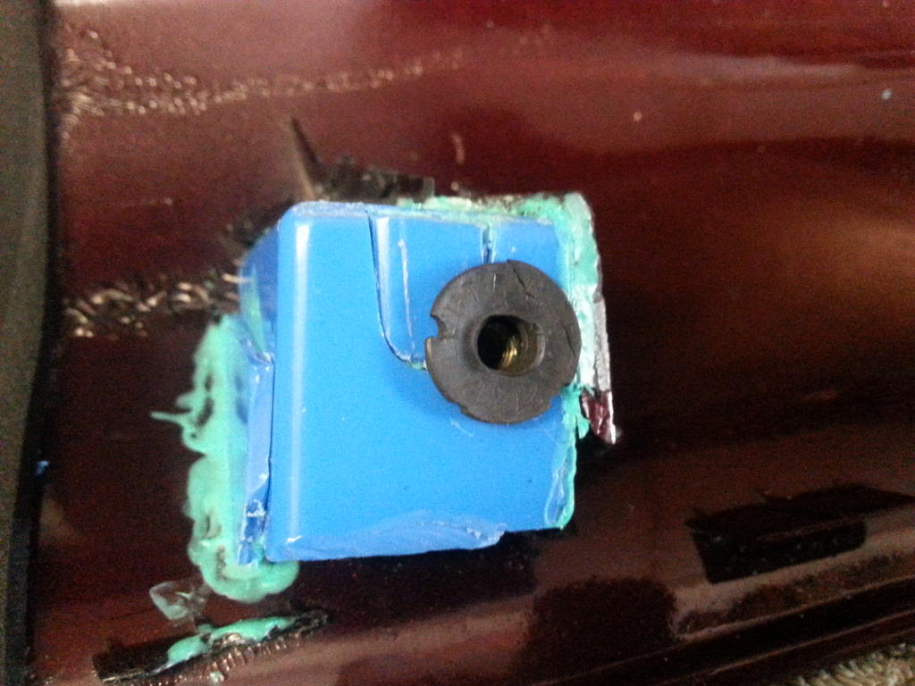

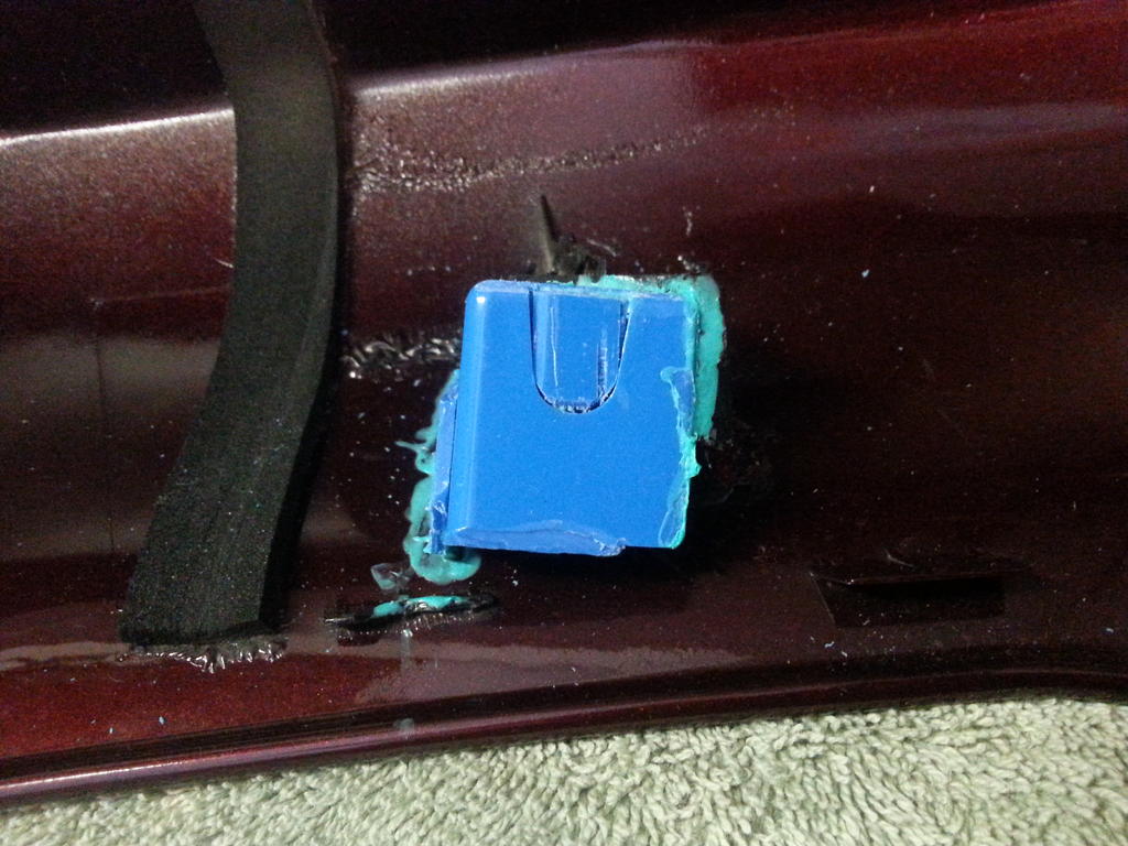

beastwood Posted June 22, 2017 Posted June 22, 2017 Well, I discovered the left lower cowl was floppin' around on my 2008 RSV. It may have something to do with me dropping it on a U-turn. I took it off and discovered that one of the three mounting points was cracked and some of it was missing. Still was able to find the threaded nut that was needed. The cowling is ABS plastic, which I didn't have any material available. But I had an extra PVC electric box. With the new "transistions" glue by Oatey ( ABS to PVC), I thought I would give it a try. The final step was drilling and inserting the threaded nut.
