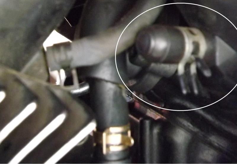

V7Goose Posted October 31, 2014 #37 Posted October 31, 2014 OK, here is yet another test that can prove if the cylinder can fire or not - remove the cap from the vacuum nipple, and when the engine is idling, spray some starter fluid or carb cleaner in the nipple - idle speed should pick up and header pipe should get hot. If it does, then you know for a fact that the carb is NOT feeding proper fuel at idle. Goose

hoochster Posted November 10, 2014 Author #43 Posted November 10, 2014 (edited) I did try that test and nothing happened. I am assuming I did it correctly. I took the "rubber boot" off of the vacumm thing (Assumed it is the "Vaccumm Nipple that was referred to) and sprayed some carb cleaner in it and there was no change. The hole was really small but I think I was able to get the cleaner in it. I order the Carbtune on Thursday and will try to synch once it comes in. He is absolutely correct in me not being a huge mechanic so this is all new to me and I am not the original owner so not sure if anything was done to the bike prior to me owning it. Edited November 10, 2014 by hoochster
hoochster Posted November 10, 2014 Author #44 Posted November 10, 2014 (edited) Attached is a pic of where I sprayed the carb cleaner to see if the idle changes as goose suggested. Is that the correct place? I just want to ensure I am testing it correctly since I didn't get any change. I only prayed it for a couple seconds because I wasn't sure how long and didn't know if carb cleaner is corrosive on the other parts of the bike. Edited November 10, 2014 by hoochster
