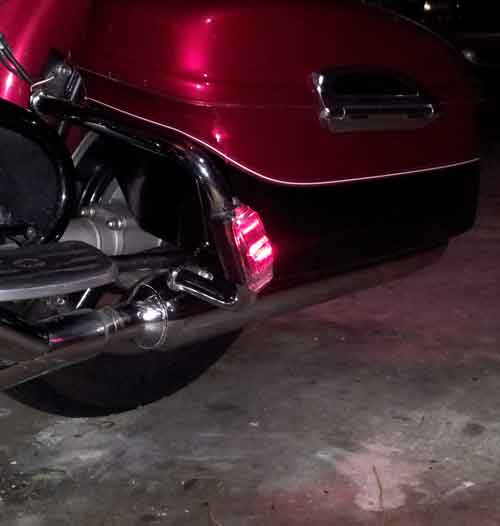

XV1100SE Posted July 14, 2014 Share #18 Posted July 14, 2014 I purchased the red/amber LED marker lights. The fork (amber) lights shouldn't be an issue hooking in (into fairing). I want to do the saddlebag rail (red) lights but not sure how to get the wire to the marker. The marker has a bolt/nut combination but it isn't long enough to go thru the rail. Would require a second hole in the rail for the wiring. Question is... how do you get the wiring from under the seat to the rail markers? There is a hole where the saddlebag guard comes out but getting it into the horizontal rail there is no opening (other than for the bolt that fastens the two). Do I drill a hole beside the bolt hole? Link to comment Share on other sites More sharing options...
M61A1MECH Posted July 14, 2014 Share #19 Posted July 14, 2014 Send a PM to bill4you502 he just installed a set that I wired up for him. I set it all up for him so it was all plug and play, but he found that some one at his dealer had cut the plugs off off the harness under the seat, but he got it all working. Link to comment Share on other sites More sharing options...
EasyRider Posted July 15, 2014 Share #20 Posted July 15, 2014 I purchased the red/amber LED marker lights. The fork (amber) lights shouldn't be an issue hooking in (into fairing). I want to do the saddlebag rail (red) lights but not sure how to get the wire to the marker. The marker has a bolt/nut combination but it isn't long enough to go thru the rail. Would require a second hole in the rail for the wiring. Question is... how do you get the wiring from under the seat to the rail markers? There is a hole where the saddlebag guard comes out but getting it into the horizontal rail there is no opening (other than for the bolt that fastens the two). Do I drill a hole beside the bolt hole? used a long single thin copper wire and a needle threader at the hole wear the reflector mounts to pull it out Link to comment Share on other sites More sharing options...
XV1100SE Posted July 15, 2014 Share #21 Posted July 15, 2014 I don't have a problem with getting the wires into the saddle bag guard... just wondering how people got wires thru where the rails connect to the guard. Area circled in picture. Where the rail meets the guard there is a bolt that goes thru the guard and a solid piece in the rail with a threaded hole for the bolt. Did people that did this drill a hole thru the solid piece in the end of the rail? Link to comment Share on other sites More sharing options...
Wizard765 Posted July 15, 2014 Share #22 Posted July 15, 2014 Don: In the one photo of the red one installed they didn't have the bag guard rails so the reflector was installed in the original location on the passenger crash bar.. I'm also interested in this so if a solution to get the wires into the bag rails is worked out it would look great... Link to comment Share on other sites More sharing options...
vzuden Posted July 16, 2014 Share #23 Posted July 16, 2014 Have you guys considered running your wires inside the chrome piece that follows the arc of the fender to the rear of the bag guards? It looks like you could drill a hole in the guard back there in order to get the wires inside. Just a thought Link to comment Share on other sites More sharing options...
bill4you502 Posted July 16, 2014 Share #24 Posted July 16, 2014 Just got mine installed and they work great!! Will post pics when I return from KY Bike Week at "Little Sturgis, KY" Had M61A1MECH wire them for me and was truly "Plug 'n play" Contact him w/ particulars for your ride. Rear reflectors come apart and pry out of holder so you don't hafta' drill into guard to run the wires either to under seat harness or rear wire bundle at tail light!!.....:cool10: Link to comment Share on other sites More sharing options...
