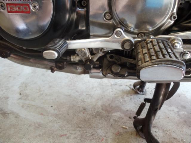

When back together the knurled piece should be pointing down and the arm should be diagonal. If you are off a tooth you will notice ithe knurled part does not move as far in one direction as the other direction...
Posted (edited)
Pictures attached of shift linkage installed.

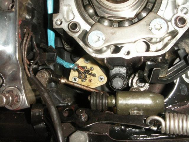

The gasket thickness does make a difference.
Also RTV where the cables for pickups & alternator pass through rear of case.
Gary
