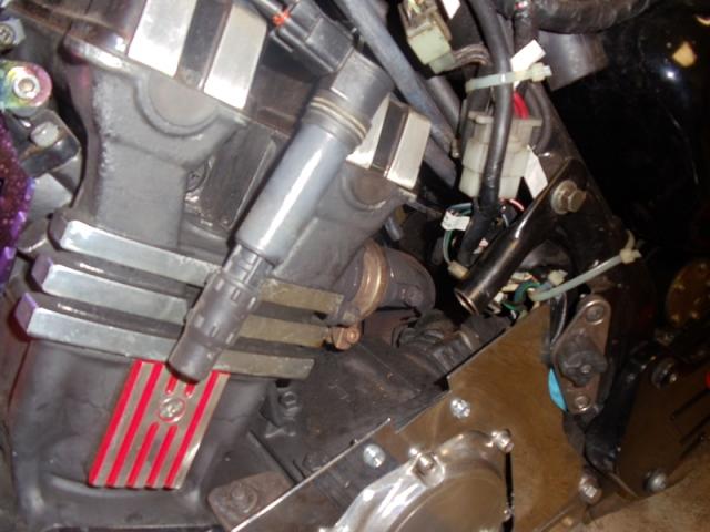

dingy Posted December 27, 2011 Posted December 27, 2011 (edited) Here is a couple of pictures of sideplates on my 83. They have been cut down in length to clear the different configuration of the Vmax heads. They were polished, then powder coated. Then I sanded through the powdercoat to expose aluminum & polished them back out. Gary Edited December 27, 2011 by dingy added current picture
