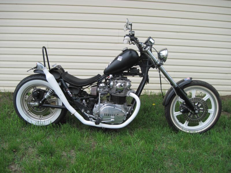

eagleeye Posted November 9, 2014 Posted November 9, 2014 (edited) Yup to all of those reasons that I ran a rear on the front when I ran a CT on the back. But my other reason is that the HD tires, (dunlop) front vs rear, the rear not only has lots more tread, but a wider whitewall. and I LOVE my WWs! Now, the reason that next spring when I put on another CT, I will not put a rear on the front, cause it just lasts too long, and cupped badly at 30,000 when I changed out the CT. The rear on the front still had lots of tread, so being a rear anyways, I put it on my XS650 bobber, on the rear. So that worked out well for me. Edited November 9, 2014 by eagleeye sp
