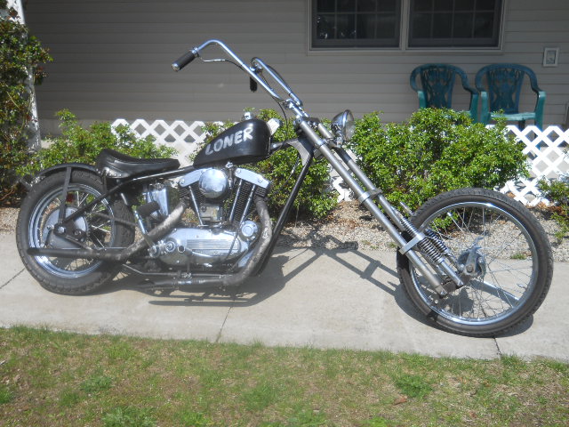

JPS Posted April 26, 2010 #26 Posted April 26, 2010 Zagger, that is one NASTY looking machine, and I mean nasty in the GOOD way! you've got yourself one head twisting and unique ride, for sure! (and the young lady is not hard on the eyes either!). Thanks for sharing the pics.

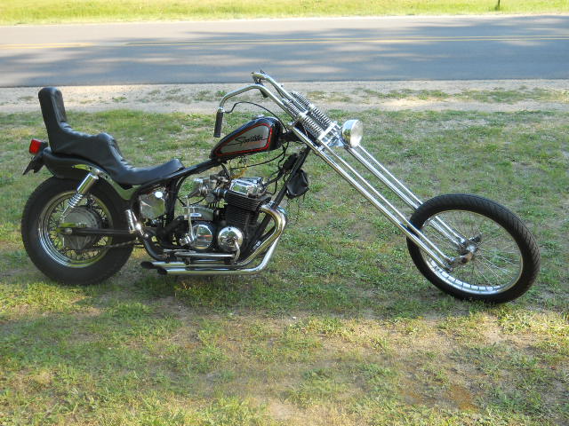

cowpuc Posted April 30, 2019 #33 Posted April 30, 2019 I tried numerous extended fork options thru the years from just extenting the tubes to Springers and even a couple Grasshoppers (pic of sporty below is a Grasshopper = very easy to build a DIMS = love the look, hate the ride). Bar none, the very best tourer chop I produced was the black Honda on a Santee Softride frame with the 16" over Springer = WOWZY WOW WOW WOW did it ride = best hiway riding scoot I ever had = Springers not only ride off the rockers but the "flex" in the "tubes" make for an amazing soft, pillow like ride = just beautiful!! IMHO, the key to getting a good handling long bike is to set the "trail" as close to zero as you can get it (especially if going more than 10 over) without going into negative trail (causes MAJOR tank slapper problems = not safe!). Over trail is not quite so unbearable/unridable, it just makes the front end "heavy" and want to flop when slow speed riding and/or parking = just hang on to the bars and you can totally control the flop = totally stable once the gyro effect kicks in from spinning wheels. When cutting the frame to rake one so the bike sits parellel and dont look goofy (or end up top heavy) because the frame is not raked (see pic of Craigslist scoot in link to get an idea of what I am speaking of) properly, just be careful and take your time measuring trail as you rake it, get the trail 1/2 to 1/4" inch off zero before you weld er up and you'll be fine, IMHO of course. https://holland.craigslist.org/mcy/d/holland-1997-harley-davidson-softail/6877873764.html

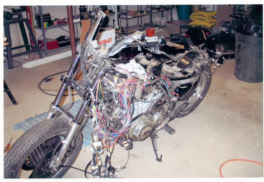

zagger Posted May 4, 2019 Author #37 Posted May 4, 2019 Harddrv1 said: Yup I’m still around been busy at work I try to update here https://www.venturerider.org/forum/showthread.php?140688-Harddrv1-bobber-build&highlight=Harddrv1 when I can as you can see it’s a work in progress taking it 1 step as a time as I can I noticed that you had a question about wiring. On my bike, I traced each wire, figured out what it was for, and cut it out. Nearly everything can be eliminated, if you want. When I got done chopping wires, I rewired the bike with only the stuff it actually needs to operate. If you don't cut out wires, you are left with bundles of wire that are impossible to conceal without the stock plastic fairings and covers. There are plenty of online sources for quality wires in all sizes, colors, and types of insulation - I wouldn't try to use the junk stocked by your local hardware store. The wire should be tin coated so that it is easy to solder (not just bare copper) and you will need a decent soldering iron. Before soldering, you slide one or two pieces of heat shrink tubing over the nearby wire and after soldering you can slide the heat shrink over the area of the solder joint and seal it up. I used heat shrink that has an internal coating of meltable sealant so that the final solder connection becomes completely sealed. Although it seems pretty permanent, the sealant will crack open if you ever need to remove the heat shrink tubing for some reason. zag

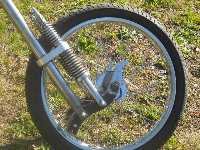

Harddrv1 Posted May 5, 2019 #38 Posted May 5, 2019 Yes I’m still fighting wireing issues redoing it would have been the way to go perhaps this winter I’ll do it again for now I just tried shorting them which turned out horribly but will get me going this summer with any luck, I am learning allot with this project I’m defiantly no master builder lol I’ve just been trying to get a bike for years and the price was right on this 1 and restoring it just wasn’t an option so doing the best I can to learn I seen in your pic where your leading link was only tacked did you build this out of pipe? Or is that solid stock? Is the leading link attached to the original fork tubes or did you have those made as well.
zagger Posted May 5, 2019 Author #39 Posted May 5, 2019 Harddrv1 said: I seen in your pic where your leading link was only tacked did you build this out of pipe? Or is that solid stock? Is the leading link attached to the original fork tubes or did you have those made as well. If you mean plumbing pipe - then the answer is no. And I didn't use the original fork tubes since they were much too short. The leading link front end was made out of fairly thick wall steel tubing (1/4" wall as I remember). The tubes which go through the steering head had to be turned down on a lathe a little bit so that they fit correctly. I had to bring the rough tubing lengths to a shop with a hydraulic bending machine so the bends could be made without distorting the tubes. Then I cut them to the proper lengths and ground a taper to the ends of the tubing so that the welding could start at the inside diameter of the tubing and fill the tapered area all the way out to the OD of the tubing. My welder was to small to handle material of this thickness and my welding skills were too limited so I had to have a shop do the welds. I simply tack welded the pieces together in the proper position so that the welding shop just had to finish the joints. As I recall, they would start each weld using their equipment and then grind off my little tack welds as they progressed around the tube. I bought a small milling machine so that I could machine the pieces where the leading link joins to the fork tube and the pieces on the leading link which hold the axle. Each of these machined pieces goes inside of the tube a little way (about 1") and has a taper where the weld had to be made to join them to the tubing. The front end took an entire winter for me to build. That is why I suggested that you might want to buy the extended straight forks which I used initially (I just remembered they were machined by http://franksforks.com/). These longer fork tubes had to be made in a shop that specializes in fork tubes since they replicate all of the details on the stock fork tubes. They are still in excellent condition and are sitting in my basement shop. If you want an extended front end, these tubes would get you going and you could decide if you were up to taking on the project of a completely custom front end. Of course, even these fork tubes will require angling the steering head so the long forks don't cause the bike frame to sit up at an angle. Cutting the down tubes and bending the steering head upward and reattaching everything is enough of a project. zag
