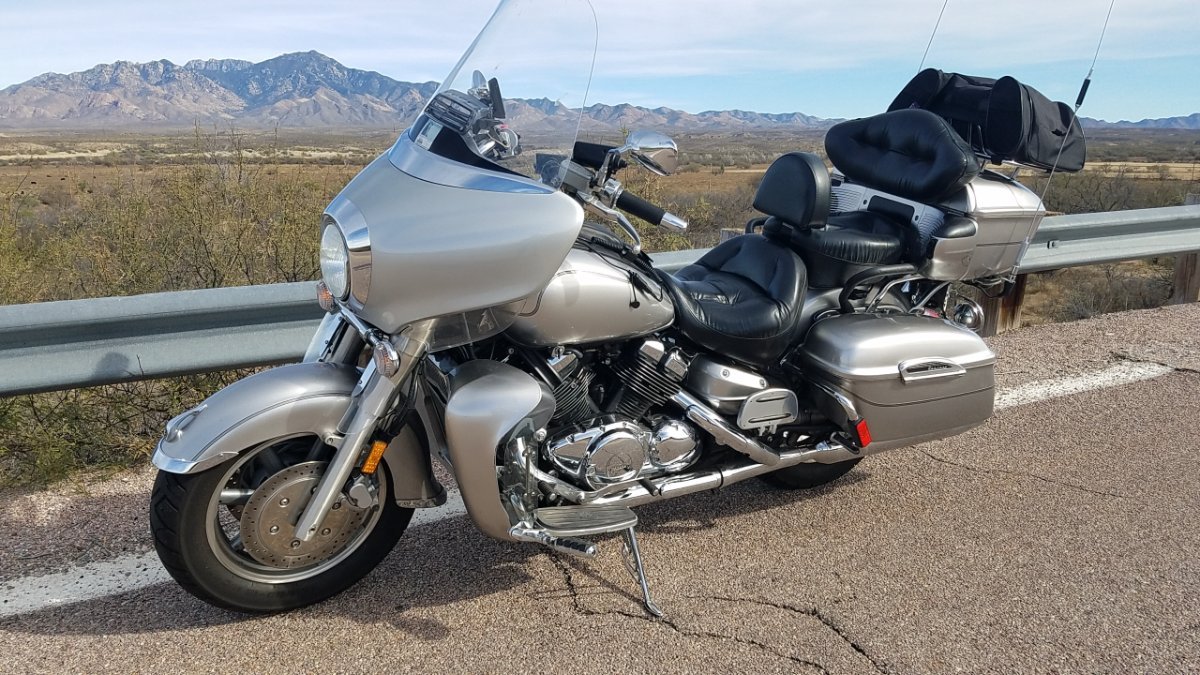

videoarizona Posted May 12, 2022 Share #7 Posted May 12, 2022 This is what you should get when Clearview installed. Hope you got the vent. If not, call them. 1 Link to comment Share on other sites More sharing options...
