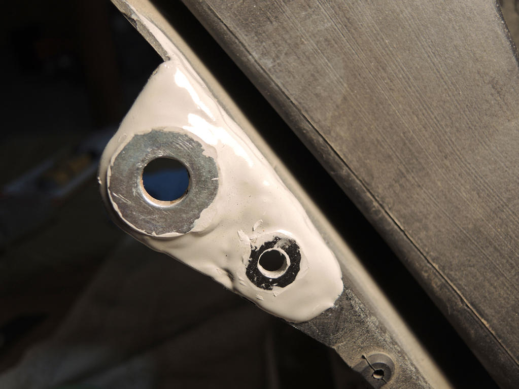

This might be an option if you still need washers. Replaced mine last year due to corrosion. 'Skydoc' was prepared to fabricate washers if I couldn't find them. In the end, found a local fabricating machine shop that sliced a couple of SS washers off a matching pipe. Used course steel wool to smooth the edges. Attached my original sketch with dimensions.

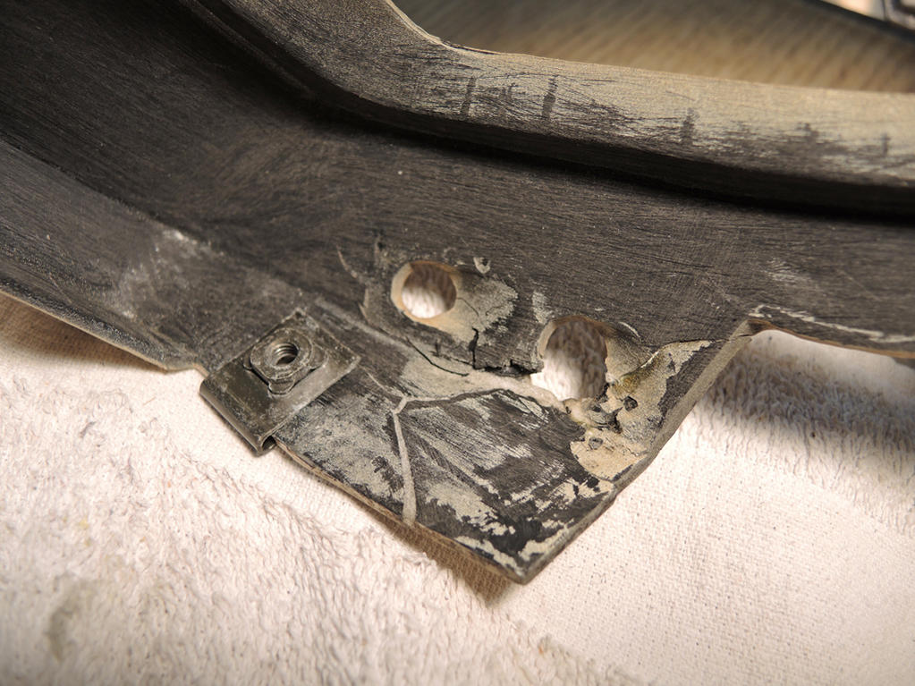

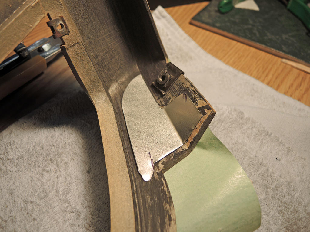

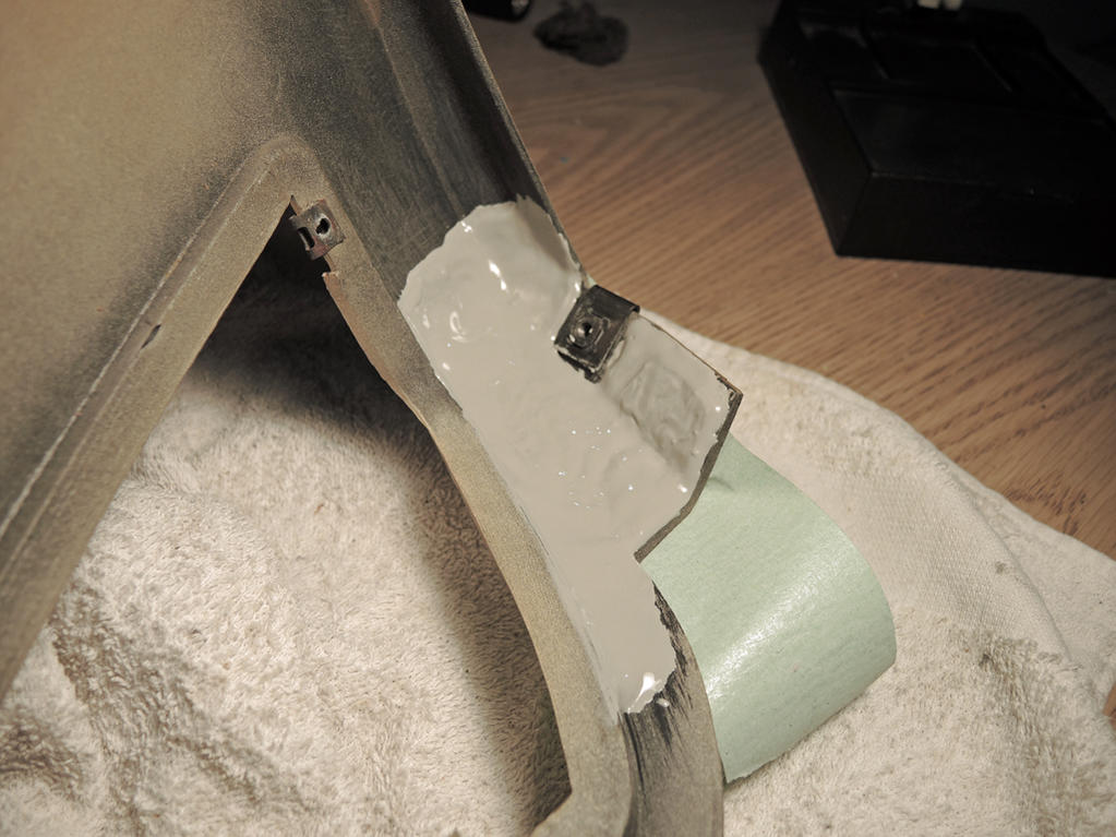

Welcome... Ahhh, plastic repair can be quite the learning curve. Removed AMFMcassette (extra weight) and installed storage basket in it's place. Lots of good repair methods on board using 'search'. I found Dominion 2 part plastic epoxy works well for most repairs. For major cracks I'll reinforce with 20 gauge galvanized sheet metal. Cracked corners and missing pieces of plastic reinforced with washers and same epoxy from inside. It's not pretty but does the job and isn't noticeable from outside. Haven't had any failures to date over 5 years, time will tell long term. good luck Should add that a layer of epoxy was first applied on plastic, then positioned piece of sheet metal on epoxy, and then another layer of epoxy to bury the metal.
