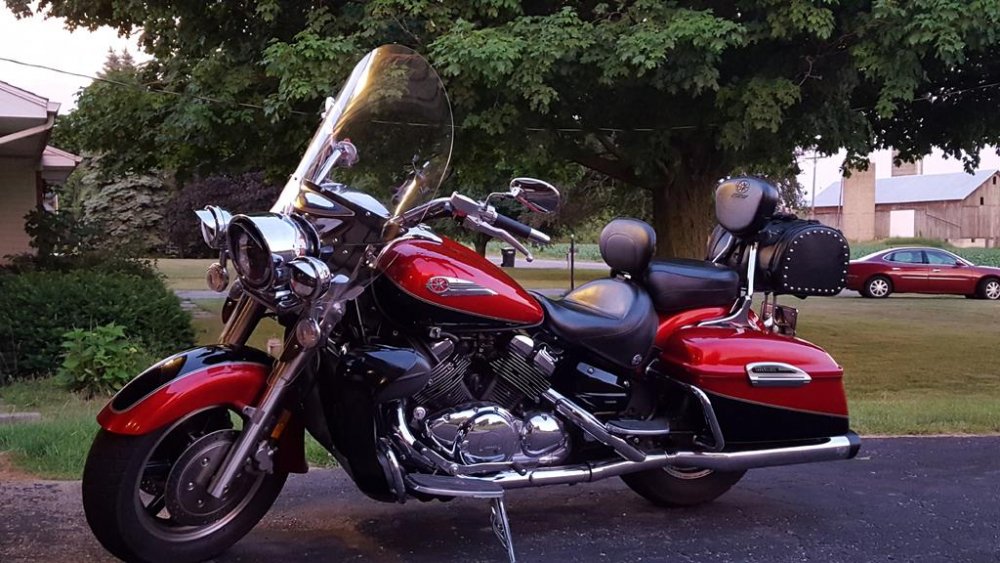

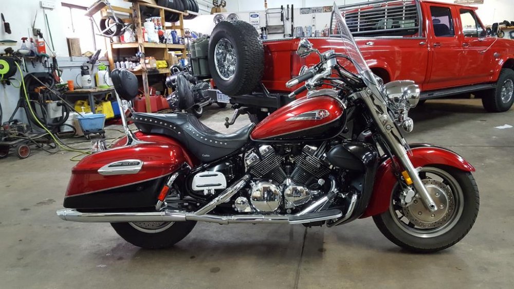

	In with the New. Why did we (I say "WE" but really it is my wife's bike, She just lets me take her for rides on it) sell the 97, because opportunity presented itself, in the form of an 07 Royal Star Tour Delux. Since I own a car lot I am always shopping for inventory, well I ran across this 07 with 11K miles on it in West Virginia for $4,000.00. I talked with the owner a few times and decided it would make a nice addition for the car lot inventory, and got it for $4,300.00 including shipping. Figured I could make a cool Grand, and play with it while it was up for sale. It was sitting in the shop when Lori came in to work on a Friday she saw it and it took her breath a little, There has not been another bike that cough both of our eyes enough to consider keeping it and selling the 97, this one did,.. Well long story short (yea, I know "too late") after a few 400 mile weekends we decided we are keeping the 07. With that decision made I had work to to, Transfer lots of parts from the 97 to the 07 before putting it up for sale. Vance and Hines Monster Ovals, Stebel Air Horn, Truck Light LED head and driving lights, etc. But we got it done! Pic of the bike when we got it: And now with the exhaust, Headlights, Luggage rack, gauges, added a 12V charging port, Changed out the Corbin Seats for Mustangs, and a few other misc parts. Lori and I love the bike, We put 725 miles on it over the 4th of July weekend, so it is getting broke in well, The next big project will be replacing the windshield with a Bat-wing Fairing, That will be coming in today. Looking forward to getting that done. We upgraded to a 10 year newer bike, with almost 60K less miles on it. Fuel mileage is Greatly Improved, got 45 45 and 46 MPG on 3 tanks last weekend, with a larger fuel tank, cruising range is 170 to 180 before reserve, instead of 120 with the 97. Love That!!! So when it is all said and done with all of the improvements and selling our old bike it will cost us out of pocket around $1,500.00. That is a lot of upgraded bike for not a lot of money! Happy Riders here!

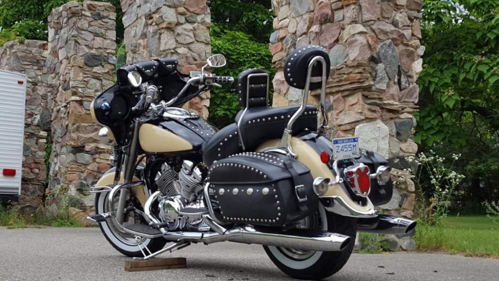

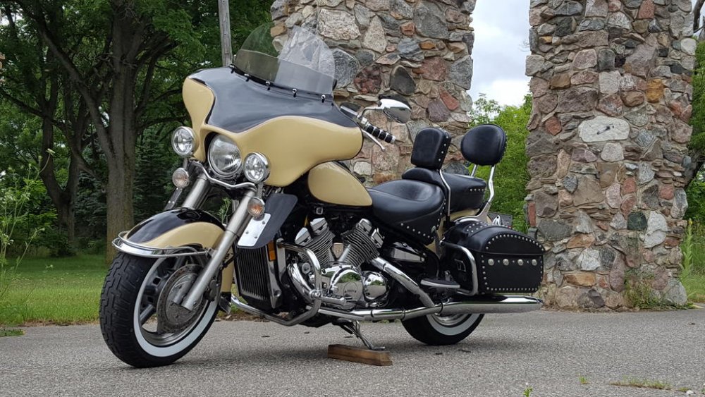

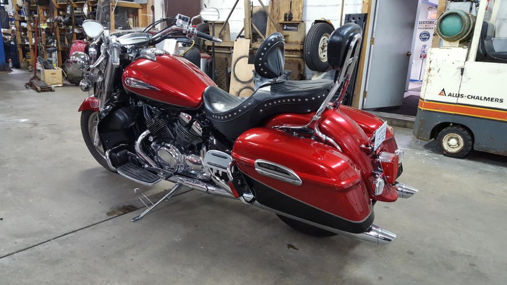

	After purchasing our 1997 Yamaha Royal Star Tour Classic back in 2011, putting over 40Kmiles on it, and doing lots of work on it, It was time to say goodby. It was sold and picked up yesterday. Here is a pic of the day that we bought it: http://i1306.photobucket.com/albums/s564/Darrin-GT/1997%20Yamaha%20Royal%20Star%20Makeover/1996YamahaRoyalStar001_zps4b5dccf3.jpg A couple pics of the bike after completion,.. Ready to sell pics,. and Sold! So that is the Out with the Old,..next, In with the New,...
