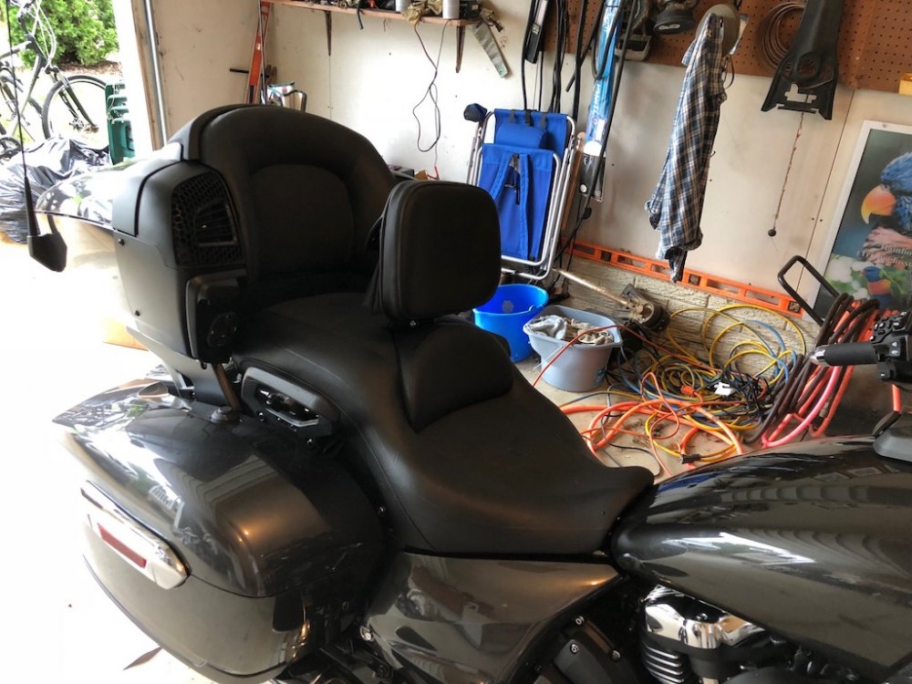

Moving the trunk back
Freebird replied to Freebird's topic in Star Venture and Eluder Tech Talk ( '18 - Present)
Yea, you are probably right. I still think it would be better if you could move it back maybe an inch but it's fine the way it is. -

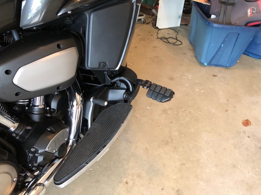

Backrest and Highway Pegs
Just an update for you on these footpegs. They do slip. I have them as tight as possible and they will still turn on the crash bars. I think a thin shim around the bar made from an aluminum can would solve the issue but I'm not going to mess with it. I'm just going to drill and tap a hole and put a recessed allen head set screw in them. Otherwise, I like them and have no regrets. Like I said before, I would probably have purchased the Kuryakyn brand if they had made them with the 1" clamps but they don't. So these were the choice and they will be fine with a little modification. -

I wish it were that easy. I got up this morning and looked into this issue a bit further. Yamaha has made it very difficult to impossible to move the trunk back. I pulled the liner out of the trunk and found that there are 4 bolts that bolt the trunk to the steel frame underneath. I removed those 4 bolts and the trunk was loose but wouldn't move back. Then I noticed that the nuts that hold secure the passenger backrest were preventing it from moving rearward. So I removed the passenger backrest and there lies the issue. There is a steel frame that is welded to the trunk support assembly. The bolts for the passenger backrest go through that steel frame and then through the trunk. So it's really the steel frame that supports the passenger backrest, not the front of the trunk. So, you could make some spacers to go between the backrest support and the trunk and move the trunk back, It moved back with no problem, but that defeats the purpose because the passenger backrest does not move back with the trunk and therefore you still have no more passenger room than you did before. So this issue is pretty much put to bed, in my opinion. The only solution that I can see would be to make some major modifications to the entire truck support/backrest assembly and that would require some cutting and welding. Something that I'm not willing to do. Then I had to mow the yard and had a few hours to think it through. I decided that maybe I was just approaching it wrong so took another look. I still didn't come up with a good solution though. I'm attaching a drawing of the bracket that would have to be modified. The only way I see to move the trunk back would be to cut the tubing somewhere around where I have placed the arrows. Insert and weld some sleeves inside the tubing. It would be easy except for the bend on the front tubing. I don't think there is enough straight run there to insert a sleeve. It would probably have to be bent and welded. There just isn't an easy way to do this. I've actually thought about buying an extra bracket to see what I could do with it but they are about $300.00. The good news is that my wife went for a ride with me today for the first time on this bike and says that she is fine with it as is. -

Here is where I got mine: https://www.ebay.com/itm/153055009408 https://www.ebay.com/itm/153055067438 I have read some reports that these pegs won't tighten enough to prevent them from turning on the crash bar if you put a lot of pressure on them. Mine seem plenty tight but if it ends up being a problem, I plan to drill a hole through the clamp and put a recessed set screw in it. -
Have any of you looked at moving the trunk back just a bit? On the RSV, there was another set of holes under the trunk and many of us took advantage of it and moved the trunk back. I think it was about an inch difference. Just a quick look didn't reveal such existing holes on the '18. KuryAkyn made a relocator kit for the Harley Road Glide that served that purpose very well and was even adjustable. My wife isn't very big but with the Utopia backrest installed, moving it back that inch would be better and give her a bit more room. I wish I had slowed down and taken a look at it while I had the trunk off during the trailer hitch install. I may have to pull it off again to see how to modify it. She may be ok, haven't tried it yet but I know it would be better a little further back.
