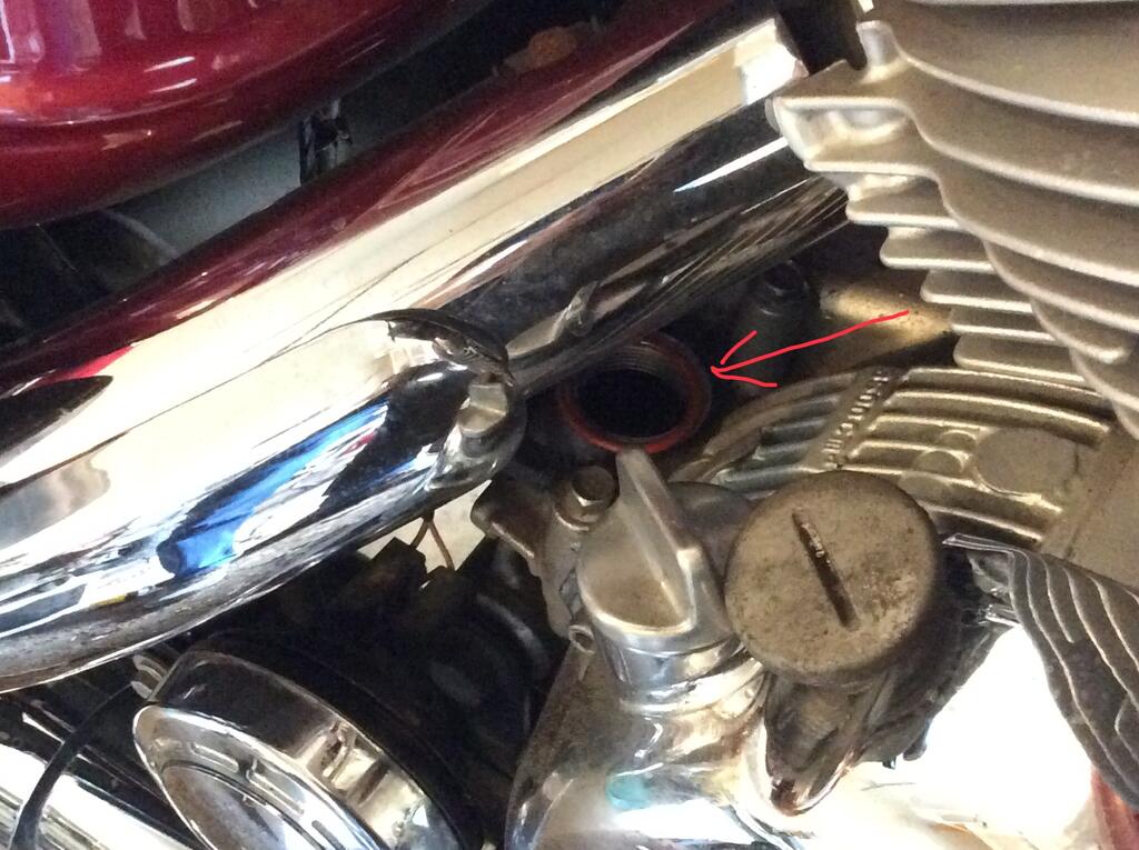

				Help identify second oil plug behind clutch
LaclaMoe replied to LaclaMoe's topic in Royal Star Venture Tech Talk ('99 - '13)
Thanks, never occurred to me. i’d guess the clutch basket design engineer was demoted to moving the oil fill hole.😂 -

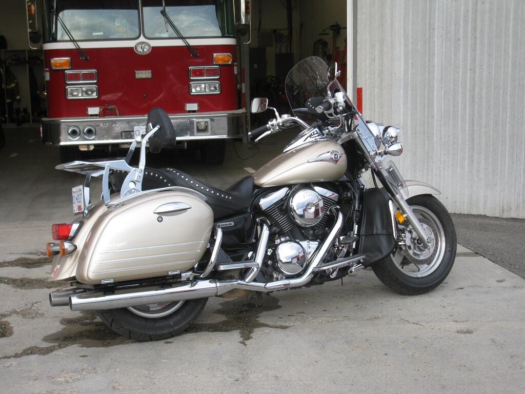

	By light i meant in comparison to the Nomad. I’m only 160lbs and was concerned about the extra 70 lbs of bike. Get on, lift off the side stand and it felt lighter. Weight is lower down. Stock bike, 150 tire. Low speed handling is similar, high speed cornering, the edge goes to the rsv. Stop quick at slow speed just a bit off balance on a Nomad, you’ll see what i mean.😱 As expected, wind protection way better on the rsv, not even close. Gf loves it. Vtwin more torque, relaxed and quiet on the nomad but the buffeting is bad. V4 more like a sport bike with comfort. But I can’t knock the Kawi, 100k faultless kms. Oh the whine at some speeds with the rsv clutch, that’s what I’m looking at now. Can’t believe they made it like that. Lucky oh yes, and i want every toy that i have.😊👍

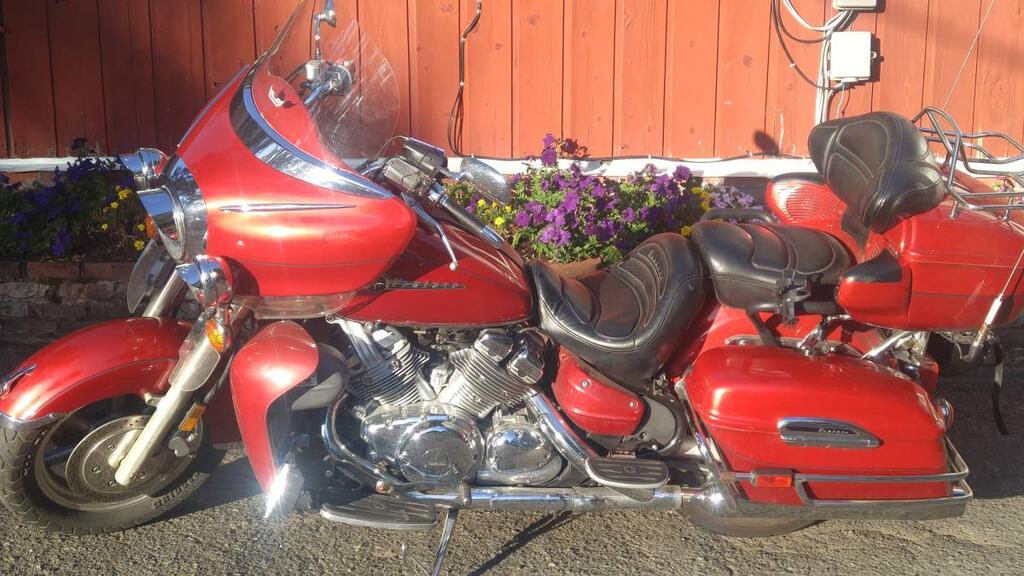

	Well no. I learned here that the red ones were faster😁 not sure why the pic is so dull.The paint really pops. Keeping the Nomad for now but....🤷🏼*♂️
	Oh! It’s light. After 10 years on my Kawi Nomad 1500 that was my first thought. Weight must be a lot lower down. If you think it’s heavy, try a Nomad. GF wants more wind protection so i bought this low milage Venture. It’s great. Impressed with no buffeting. Even rained some and my 5’ 8” could slightly see over the cut down shield. Slow speed turning is easier and it handles like sport bike. Yes the tranny whine goes away with speed. Or the harley pipes, but I’ll quieten that down.what the hell were the engineers thinking? Maybe the test riders just drove fast😁 Easy to do. I’ll google that ibasket mod or is there an easier fix? I got on, drove 300 miles home, mostly chasing rabbits. It goes good. Gearing is fine. Overall i like this bike. So does she! WIN!
