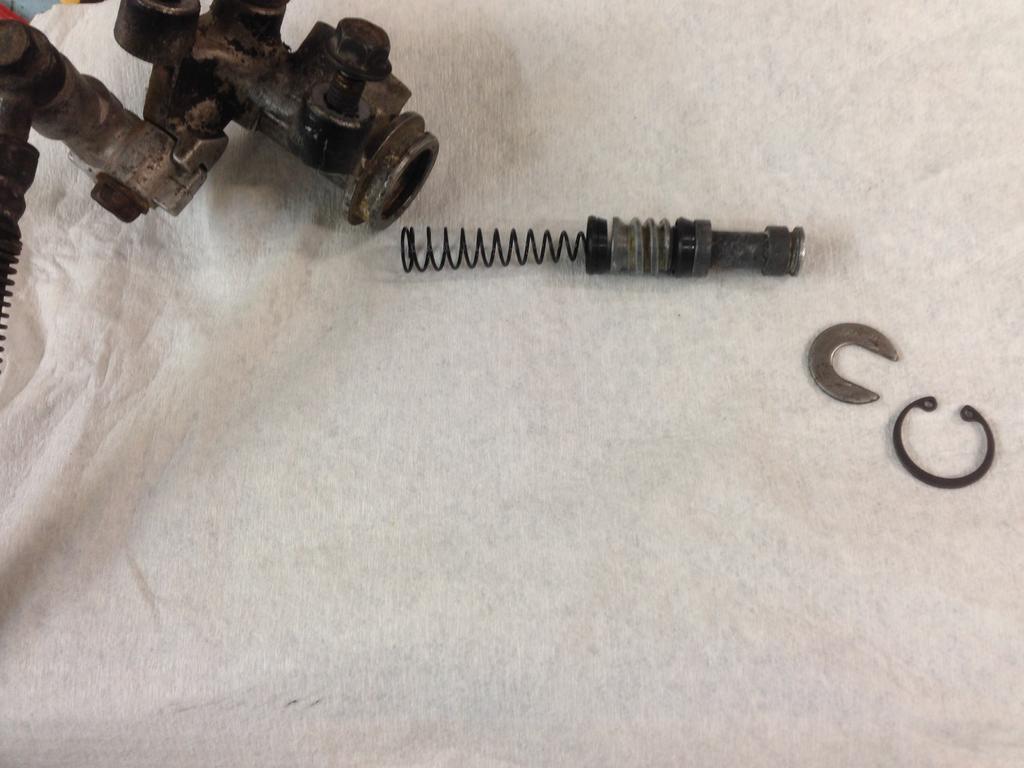

made2care replied to made2care's topic in Venture and Venture Royale Tech Talk ('83 - '93)
Rear master cylinder is done. Definitely needed it. Here a pic of the new parts that were about to go in! Next up , probably mono shock then gas tank. My new petcock came in but I guess they don't come with a little turn knob!! Will have to try to track one down. -

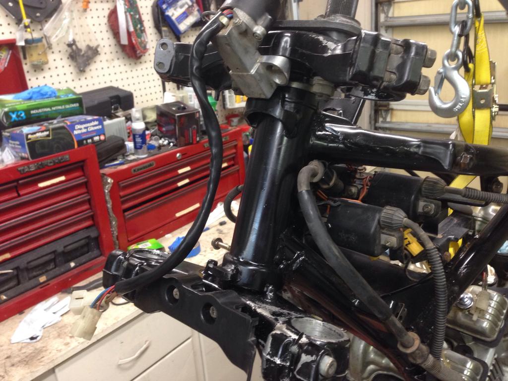

Just completed steering bearings. This was a first for me and here are a few things I noted. If u look at the lower race , yamaha actually has two slots in which you can use a long punch to tap it out. The upper does not and I had to very carefully dremmel that one out. Also, I used the old races to tap in the new ones but before that, I had the new ones in the freezer for a couple of hrs. I also had to make a slotted socket to torque the lower stem nut but to only 6nm. The next stem but is hand tightened and then u place the special lock washer on. I'm waiting to torque final nut after I put forks back on. Again my first time rebuilding steering head but it wasn't too bad. Next up , rebuild rear master cylinder. -

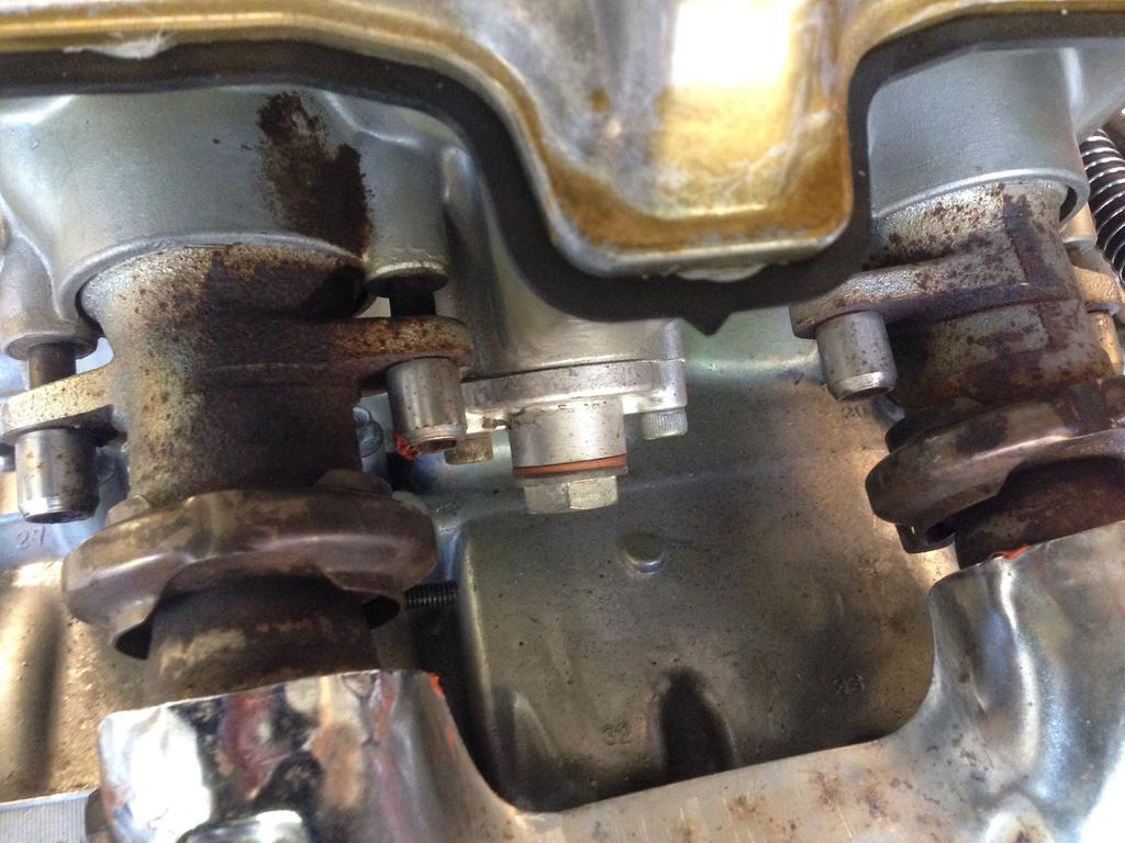

Okay, I bought new copper exhaust gaskets and fitted the little rear exhaust, tightened down the special clamps and everything is snug inside the clamps , however the exhaust is not. I realize that once I get the rest of the exhaust hooked up, this smaller exhaust will stay put but it's not sealed. Any suggestions? Permatex copper gasket sealer? -

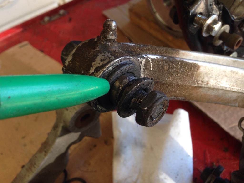

This bushing is worn and I cannot find a replacement. It appears to be a solid nylon bushing but not sure. Any suggestion? This fits into one end of the shackle/ yoke that connects to the rear mono shock. -

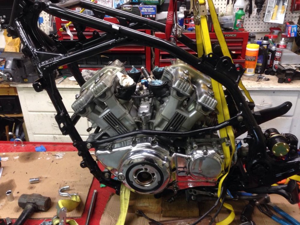

A couple of points to note when I put frame back on engine. I had to tap a lot of the engine mount bolts as they were pretty corroded. Even with doing that, the rear bolts were tough to bolt on, probably due to not lining up perfectly. I did use Randy's solid mounts too. From what I've read, this improves handling but will have a little more vibration so there's a trade off there. I believe later models went solid mounts anyway. Correcting the valve clearance with the engine standing alone was a breeze. I highly recommend getting a kit ( I used skydocs) as it speeds things up having the right tools and shims right at your fingertips. The rest of the build should be pretty straightforward. Chow 4 now. -
Well, after a few hrs and taking about 3 breaks to vent my frustration, I managed to get the engine married to its new frame. I just lifted the frame over the engine. Lots of tweaking and I must admit, this was a pain in the ars but I somehow managed to get it. Whew!! What a relief! -
