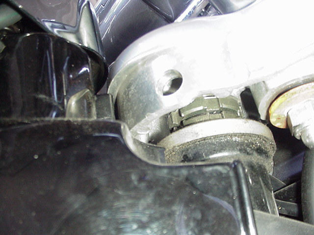

  11. Better image of how they SHOULD look

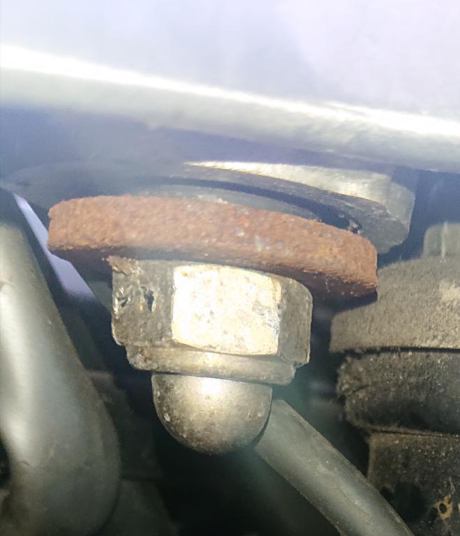

  12. I can't get in at the moment to see how tight they are (no spanner that size) there's quite a gap at the riser bolt... Here's a pic taken off this site of what they should look like (you can see it on the right) .. These are mine.... Even with out these pictures I'm convinced now this is the issue
  13. Well another quick potter in the garage after dismissing my air idea as unlikely... Grabbed the (now fixed in place) handlebars and gave them a shake side to side and up and down. There seems to be ALOT of up and down movement in the risers... More so in the left. Never shook them like that before (why would I?) so don't know how much movement there should be (my VN1500 risers are solid and don't move at all) Not sure if this is an easy fix or not? This would possibly explain why left corners felt so 'wobbly'?
