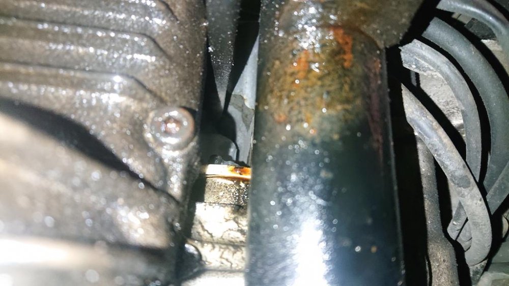

  12. Can anyone tell me where this leak (on the white bit) may be coming from? Thankfully it is a very small leak, so I'm not loosing much oil. Any help would be much appreciated On a 2002 RSV... For the avoidance of any confusion this pic is taken directly under where a centre stand would be attached Thanks in advance, Graham
