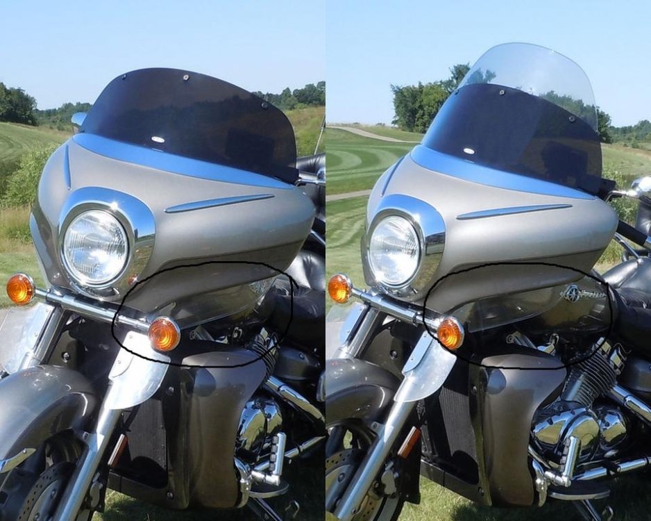

I believe I found the mounting holes under the light bar. Looking at the parts diagram it looks like the hole spacing is the same size as the brackets shown on the parts diagram. -

Okay so after examining the parts diagram it appears the fairing has to be split and the wind deflectors are screwed to the inside of the fairing. Guess I could have done that from the beginning but I was being a little lazy. -

I may take you up on that. Right now I am looking at the fairing deflectors but I would like to add the fork deflectors also. I'm not sure how the fork deflectors attach. Do you have all the hardware for them? I don't see anything on my bike that they would attach to. I have a set of fairing deflectors I can purchase but I didn't want to buy them until I know how they attach. The ones I'm looking at are the deflectors only. -

I've been looking at attaching wind deflectors to the lower section of my fairing like I have seen on some other ventures. I've only seen them in pictures and I can't tell how they attach to the fairing. Could someone who has them attached to their bike tell me how they attach to the existing fairing? Do I need any other hardware besides the deflectors to attach them to the fairing? I have noticed that I get quite a bit of wind from under the fairing that comes right up into my chest. It's fine right now but I can see it as a problem when it gets cooler outside. Thanks. '
