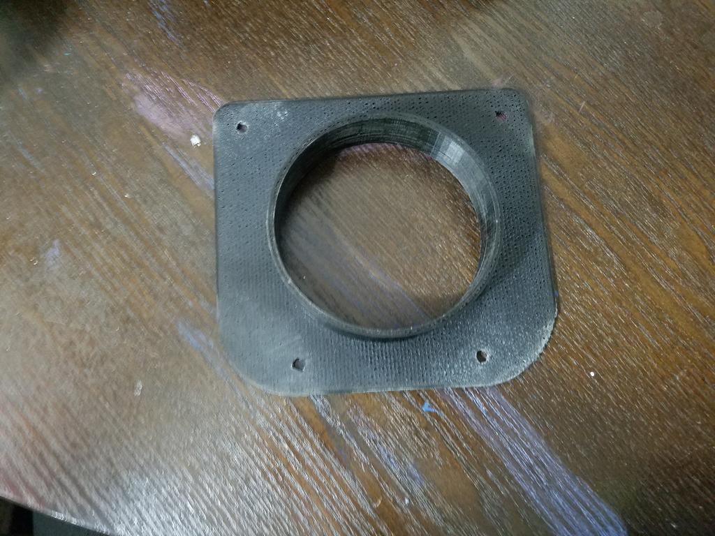

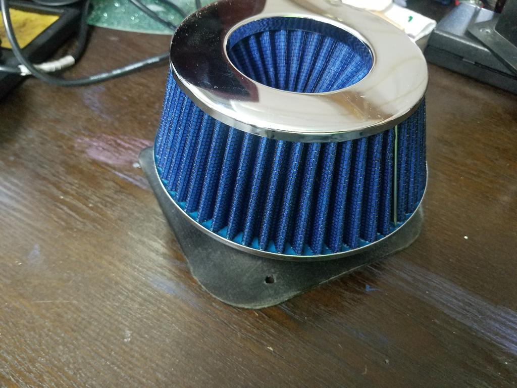

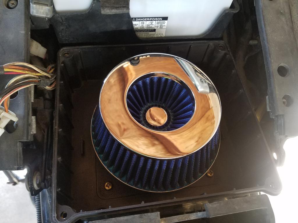

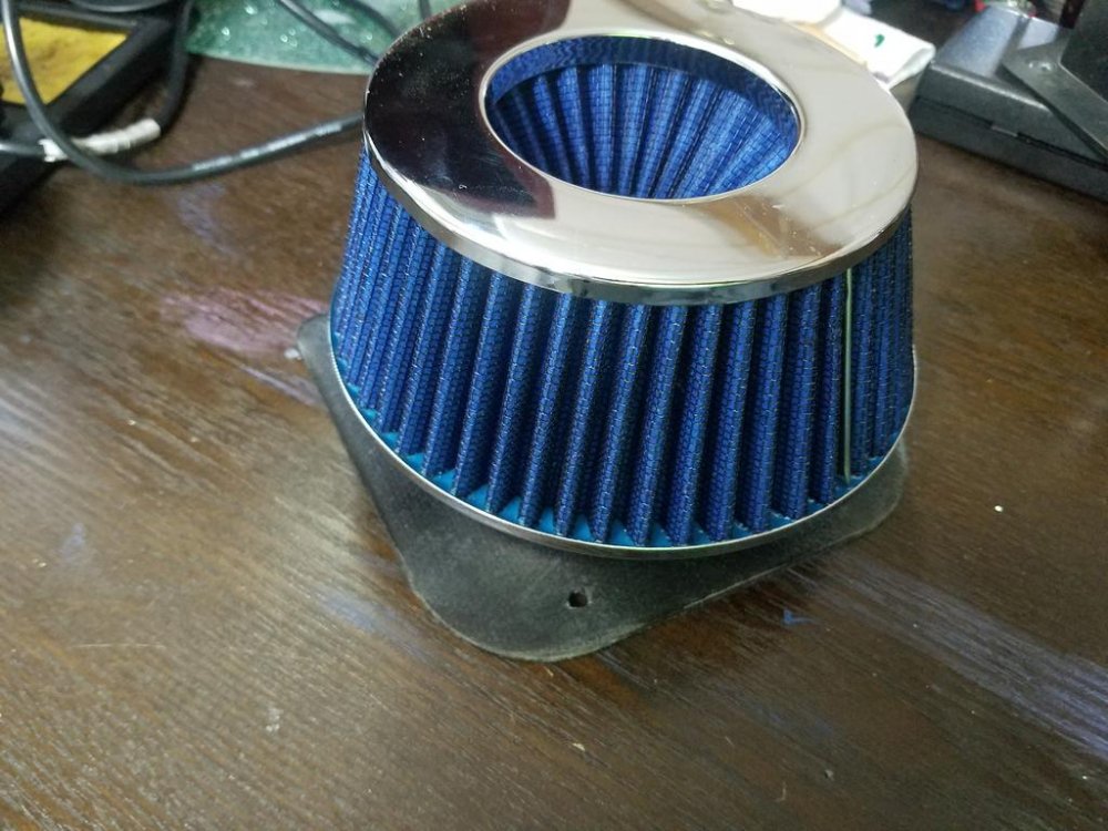

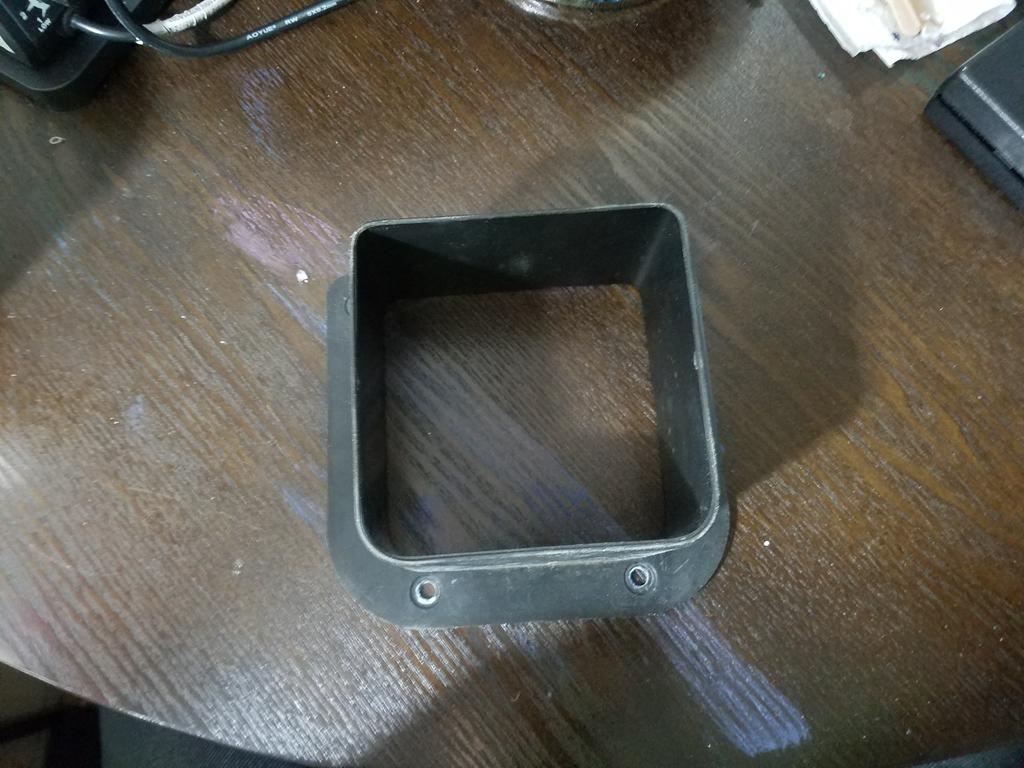

FIRST UPDATE: OK, so I got the prototype adapter printed out and put in. Needed to do a little sanding on it because it looks like I was about 1mm off on the large curves. Regarding air flow restriction, my super rough measurements on the factory filter came out to 54sq inches of surface area and the specter filter has roughly 45sq inches. So I think given the superior air flow of the specter, the two filters end up being equal (someone who is more patient and better at math than me please dig into these measurements so we can all be sure)! Pardon the sloppy print, I did it quickly to make sure it works and fits and also had to manually drill the screw holes. It mounted in great and WOW what a difference in performance. Bike no longer smells rich and the power is great. I already have the updated version printing out with the screw holes designed in this time and more top layers so it is more solid. Will update again once that's out. Otherwise the images are as follows. (1st: Original air filter mount, 2nd: prototype mount, 3rd: mount with specter 8166 filter, 4th: prototype mount and filter in factory air box) The air box cover also mounts on with no obstructions or need for modification. -

Hey everyone. I didnt see any posts about air filter mods (maybe im just lazy and near sighted) but, I decided after realizing that my running rich and afterfireing is likley due to my air filter looking like the original from 1983 and having the airflow (or lack there of) to match. I'm sure you all know its kinda hard to find these filters and there are a few DIY tricks to keep the case and replace just the filter medium. Which was the route I was going to go until I remembered that I have 3D printer!!! (insert evil laugh here). So I am going to create an addapter that replaced the little coupling inside the airbox to accept a specter cone air filter. I will update this post as soon as I have it printed out and tested, after which of course I would me more than happy to sell them out to eveyone here. Wish me luck!
