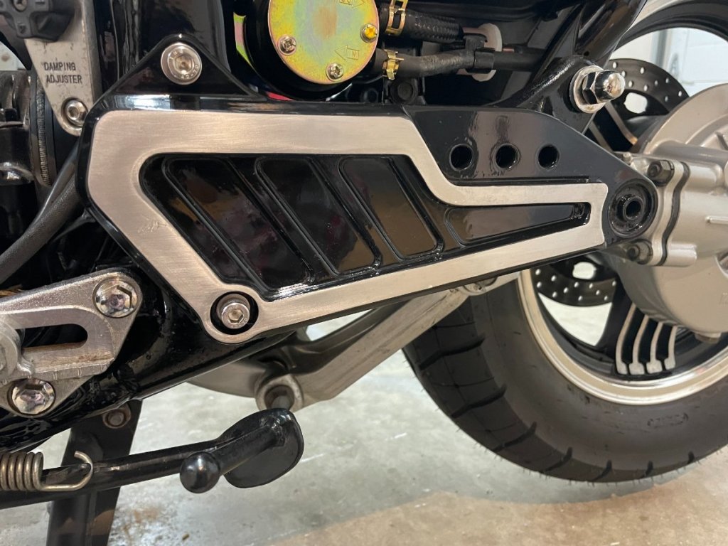

One of the small projects was the lower side plates. I sanded the clear off of the front and then painted them black. Once dried I sanded the paint off of the areas that were bare aluminum. I finished it up with a coat of clear. The interesting detail on the clear is I bought matte clear but because I forgot to stir the clear all of the matte was on the bottom. So when I mixed up a batch and sprayed these, the clear is actually glossy and not matte. Here's a before and after.

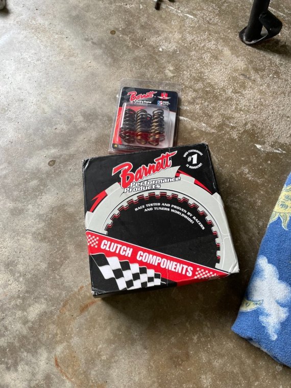

Time to revive an old thread. I spent the last summer working on plastics and they are about 80% ready for paint. I tried hard to find plastics that didn't have any cracks which is near impossible. I went as far as buying 3 different right side saddle bags where the sellers said they were crack free. I even pointed out to them where to look for cracks before I purchased them and they still had cracks. So I gave up on finding any that didn't have cracks and settled for pieces that had minimal cracking. So those will be getting some paint next spring/summer. Now on to what has been done recently. First up is a set of Barnet clutch plates and springs, along with a re-chromed clutch cover. I also installed the rear clutch master cylinder and a new braided stainless steel brake line. I just need to come up with a plug for the front brake line since I am delinking the brakes.
