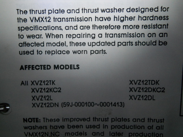

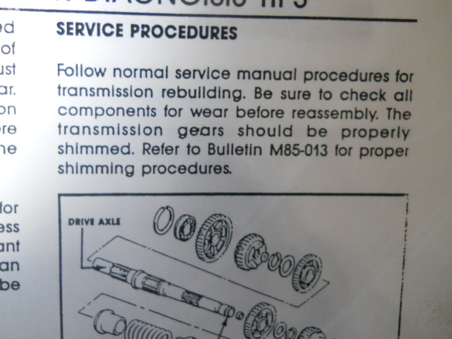

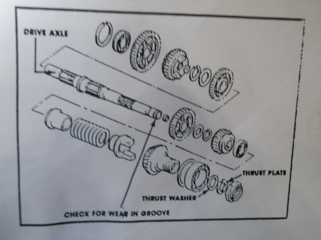

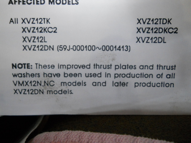

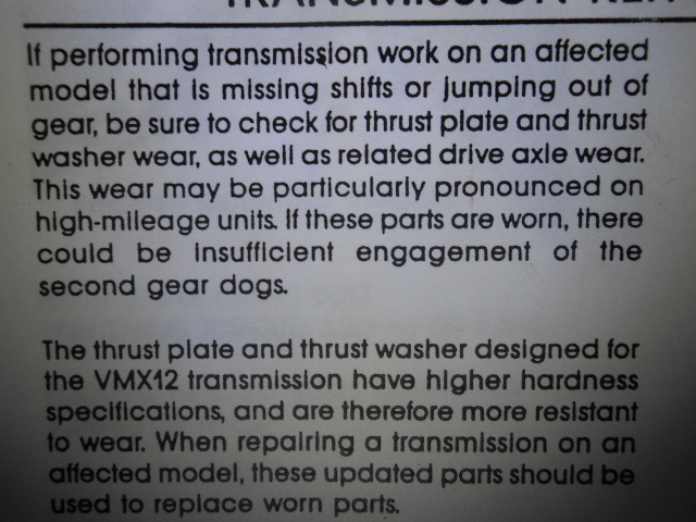

While my "M.O." has always been to by em missing 2nd gear and short shift em out to 2 or 3 hundred thousand miles so I have never actually had one down as far as you have yours Johnny (I commend you though, looking good there) I may have an answer to your question here.. Looks to me like it is actually both the washer and the plate you want to replace to be sure and also check that shaft groove very closely. I have done many other bike trannies in the past and if it were mine, I would also check those 2nd gear dogs and engagement window edges closely too.. Also the shift forks for wear (be surprised how people like to rest their toe on a shifter when they ride).. Anyway,, here is what I found in some of my accumulation of paper work.. Hope this helps!! -
