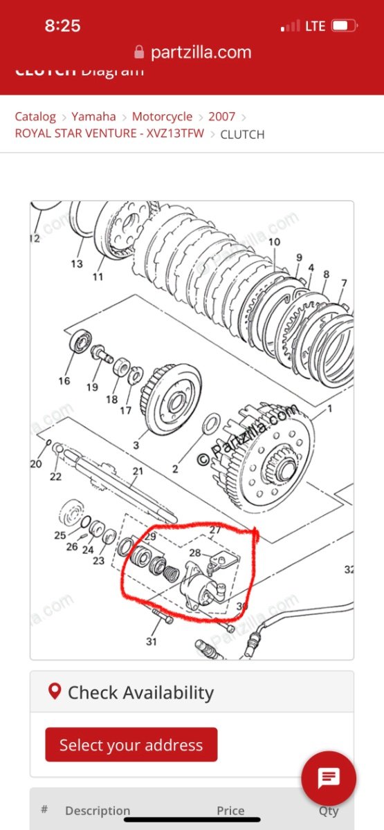

Russ Posted May 17, 2023 Author Share #3 Posted May 17, 2023 12 hours ago, Marcarl said: Left side of engine between the two engine covers. You'll need to remove the rearmost cover. It's covered by a square piece of rubber. Best get a new one for the cost of it. 2x6m allen bolts holding it in place. Careful not to strip out the bolt head, make sure your tool is well seated before attempting to turn. Thanks Marcarl! I believe I found it on the bike, will be digging into it this weekend, but I'm not finding it on Partszilla. Does it have a different name or is it in a different parts diagram other than the clutch diagram? Link to comment Share on other sites More sharing options...
RDawson Posted May 18, 2023 Share #4 Posted May 18, 2023 1 hour ago, Russ said: Thanks Marcarl! I believe I found it on the bike, will be digging into it this weekend, but I'm not finding it on Partszilla. Does it have a different name or is it in a different parts diagram other than the clutch diagram? part 27. Link to comment Share on other sites More sharing options...
Russ Posted May 18, 2023 Author Share #5 Posted May 18, 2023 9 hours ago, RDawson said: part 27. Thank you! Push Lever Comp. Silly me was looking for something labeled slave. Link to comment Share on other sites More sharing options...
