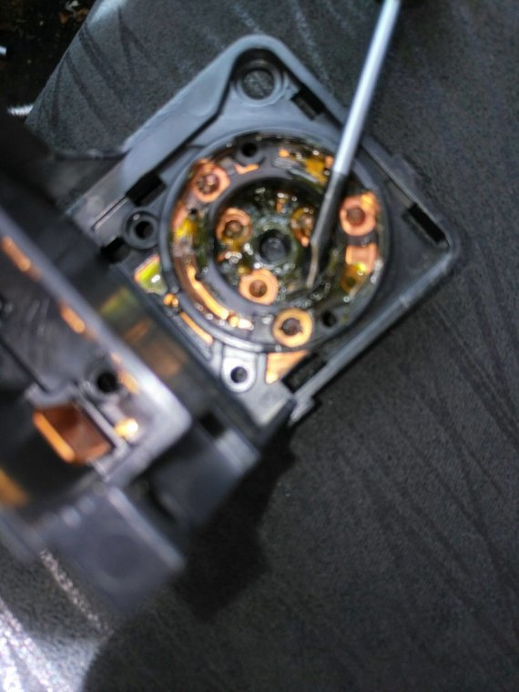

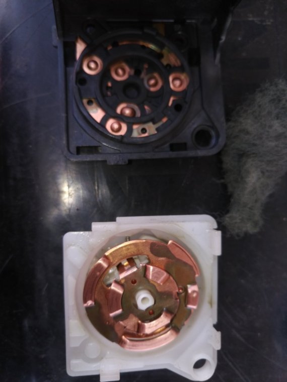

Patch Posted May 18, 2021 #1  Posted May 18, 2021 Eh guys thought I’d share this experience with you.  You all remember my brother SK, well, a woman he is close friends with a single mom with a 10 year old girl and, is pregnant at the moment. She is not a well-balanced person, talks very loudly nonstop; I do my best to steer clear! SK mentions her car broke down and I agreed to go take a look at it. The car was parked on a grade so a risky jack up but the obvious was the need for a battery. So they went and got one while I probed around. After installing it the starter would not engage, then it did but turned very slow, the car started one time. She had scraped together many parts, a starter, right axel, 4 full sets of brakes, washer container all gathered in the trunk. She couldn’t afford a mechanic so I said have it towed to my place and I’ll get it in order. A long story ensued before the car finally showed up a couple days later. I was preparing lunch for a friend (a hot spicy cold pasta salad dish I had dreamt up) and off she goes like I am deaf holding a takeout chilly in her hands……(: oh brother Yesterday I had time to work on this 8th Gen Honda Civic. Once I looked up the schematics for the starting circuit and known issues I took apart the Colom and stroked the ignition slowly while probing the start relay. SK asked on his way to work asked what I found, I explained that it had to be the electronic side of the ignition switch and that she can likely count on returning the starter and the washer container as I had fabbed up a patch! While I was pulling out the component SK had come back with a new electronic control module he picked up before heading to work? He went on to explain she had called him upset because I wasn’t answering the phone, (cashmere is my favourite troubleshooting song why interrupt perfection)  she was inpatient and upset because the “parts guy told her the starter had a flat spot and was the problem)!!! Troubleshooting is a game of patients. It is the process of elimination; we must first prove the part failure by working our way to the part noting our measurements as we proceed! We have to ignore the obvious or the assumed failed part until we confirm whatever the circuit we are working on has been proven good before changing parts. That is troubleshooting. In her shopping spree which is a $1000. All I really needed were the brakes and the battery. The axel needed a boot that’s $25. Including grease, the starter is fine, the hole in the washer is repaired (she needs an inner fender to stop it from happening again)! The switch is repaired as you clearly see below. Here’s the kicker: she won’t allow me to keep the repaired switch for say a young guy stuck trying to get to work with another Civic Gen 8 or whoever whatever the next case might be.. That’s right a shellfish hoarder yuck.  Look closely on the right and left after cleaned, there is a dimple in two of the contacts, flaw or purpose? Purpose, greater contact area signalling higher current demand. The one on the left is hard to spot but I remember cleaning it so it’s there. No sand paper, just cleaner and grey scotchbrite.
