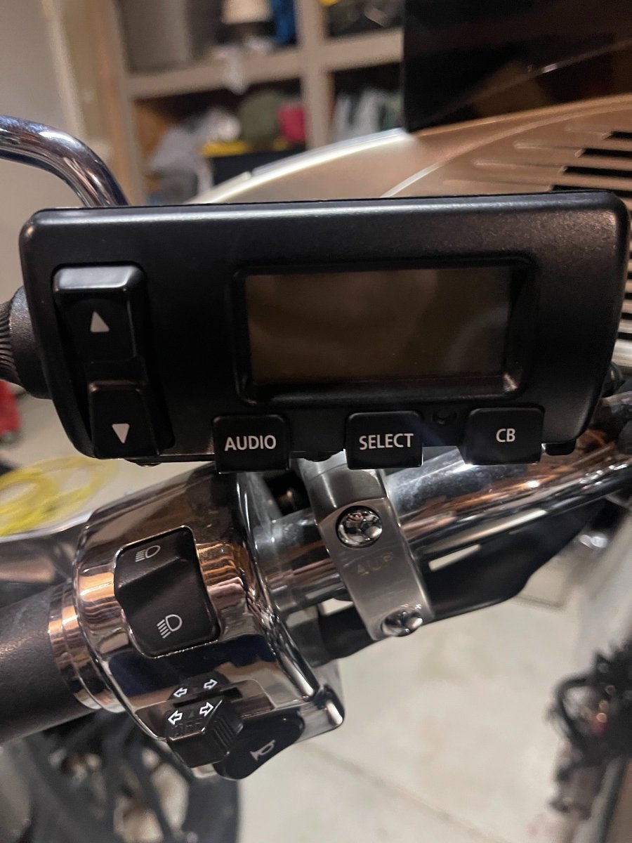

tat2dnthedesert Posted December 28, 2020 Posted December 28, 2020 I was wondering if anyone knows if they made a replacement for this handle bar mounted stereo that is Bluetooth. I am looking at upgrading stereo and speakers and thought I would see if anyone has ever seen a newer version of this.

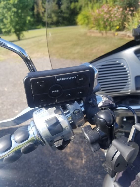

WIZ Posted December 28, 2020 Posted December 28, 2020 (edited) I've had one of these installed since 2016 big improvement. https://www.amazon.com/Waterproof-Motorcycle-Bluetooth-Amplifier-Powersports/dp/B074X456TN/ref=sr_1_6?dchild=1&keywords=marine+grade+bluetooth+amp&qid=1609132766&sr=8-6 . The control is almost identical size to the original. Ron Edited December 28, 2020 by WIZ
tat2dnthedesert Posted December 28, 2020 Author Posted December 28, 2020 Does it mount to your handlebars also? Have any pics of it mounted.
WIZ Posted December 29, 2020 Posted December 29, 2020 It mounts in the same place as the original. I had to make a bracket to attach it, but it wasn't hard. Ron 1

WIZ Posted December 30, 2020 Posted December 30, 2020 I used the existing wires. I removed the plug end from the original stereo and connected the amp wires to it so I could plug into the bikes wiring without having to cut the bikes wiring. Yes this is a amp that will blue-tooth music from your phone to the amp. I used the original bike speakers. I think they sound fine. I wasn't expecting a lot of bass just wanted clearer sound, I think that the extra watts put out by the amp makes the sound a lot clearer. Ron

OutKast Posted January 14, 2021 Posted January 14, 2021 On 12/29/2020 at 1:39 PM, tat2dnthedesert said: We’re you able to use the existing wiring also? And this is an amp that will stream music from my phone or music services. The unit on the handlebar is just the controller. The actual radio/amplifier/intercom unit is inside the front fairing. The actual CB is underneath the trunk, and of course the tape deck is in the dash. These wire back to the central radio/amplifier/intercom in the front fairing and are all controlled by the same handlebar controller. So if you replace this unit, you delete the intercom and CB. You may already know this. Just FYI. 1

PreachJohn Posted February 6, 2021 Posted February 6, 2021 On 12/29/2020 at 10:54 PM, WIZ said: I used the existing wires. I removed the plug end from the original stereo and connected the amp wires to it so I could plug into the bikes wiring without having to cut the bikes wiring. Yes this is a amp that will blue-tooth music from your phone to the amp. I used the original bike speakers. I think they sound fine. I wasn't expecting a lot of bass just wanted clearer sound, I think that the extra watts put out by the amp makes the sound a lot clearer. Ron Did you lose CB and Intercom functions with your wiring job?
WIZ Posted February 6, 2021 Posted February 6, 2021 Yes I completely removed the factory stereo and cb system.
