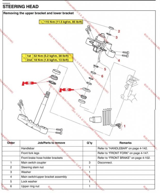

ecbaatz Posted September 26, 2020 Posted September 26, 2020 (edited) Does anyone know the size and torque specifications of the steering nut on a 2018 Star Venture? Still searching but have not found that info yet. Update: Found torque spec to be 85ftlbs 2nd update: It is a 36 mm nut Edited October 2, 2020 by ecbaatz
sldunker Posted September 26, 2020 Posted September 26, 2020 Yes, the top nut has a pretty good torque. The bearing nuts not so much
Du-Rron Posted September 26, 2020 Posted September 26, 2020 Does anyone know the size and torque specifications of the steering nut on a 2018 Star Venture? Still searching but have not found that info yet. Update: Found torque spec to be 85ftlbs I believe the tech manual is right here in the 3rd gen section.
ecbaatz Posted September 26, 2020 Author Posted September 26, 2020 I have the tech manual, that is where I found the torque after a search. Still trying to find the size. I think it might be 36 mm but not sure.

ecbaatz Posted September 26, 2020 Author Posted September 26, 2020 (edited) Is this something that needs to be checked? Serious question though it reads like a snide remark. Sent from my SM-G975U using Tapatalk Not intending it to be a snide remark. I have a wobble between 15-25 mph. My research shows it could be bearings, ($30 apiece) or the steering nut is loose. I have also heard that if rear is out of alignment it could cause it as well but am skeptical. It started before i changed the front tire. Thought it was the stock tire so put a new one on with balancing beads and still have the wobble. So I am trying to eliminate possible causes. I thought checking steering nut would be cheaper then replacing the bearings. Sorry if I offended you. Edited October 1, 2020 by ecbaatz
