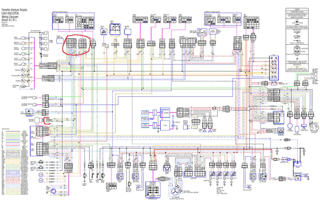

Vickersguy Posted January 16, 2019 #1 Posted January 16, 2019 After reading the dim headlight posts, because it's rude to make a post on questions already answered, my headlight issue on my '83 is similar, but different. It's also weird. The classic trouble shooting path is to check the Hi/Lo switch, which I've done. The switch is good, but I'm not getting battery voltage at the switch. I have 12.8 volts at the battery but only 10.07 volts at the blue wire supplying power to the switch. At the H-4 plug to the bulb, I have 11.7 volts to the low beam, ( the same voltage if I use a frame ground or the neg. batt. post, so no ground issue...) and 4 volts to the high beam. I figure 4 volts is the "trace" voltage the RLU uses to check the condition of the filament of the high beam. When I switch to high beam, I have 11.7 volts to both hi and lo plug sockets. I think this means the RLU is working properly. If the headlight is plugged into it's socket, I get the panel headlight white lamp lit on Lo and it goes out on Hi. If the headlight is not plugged in, the white panel lamp is lit all the time. I'm beginning to think the next step is doing the solder joints in the dash panel. However, one guy with an issue exactly the same as mine, did the solder job and it made no difference. It ended up he had a bad bulb and I do not. The H-4 bulb is totally good. I have a 2 volt loss between the battery and the headlight switch and that power goes through the dash panel. It also seems clear that the dim switch only controls where the CMU sends the power, to the Hi or the Lo on the headlight. So it's the CMU, right ? and the solder joints... I'm going to pull and return all the relays behind the headlight just to be sure there are good contacts there. Just not sure where to go from here... OH, forgot to mention, my self canceling unit does not work. I don't think that affects the headlight though.
Flyinfool Posted January 16, 2019 #2 Posted January 16, 2019 In order to get meaningful voltage readings the RLU must be plugged in and a good headlight bulb must be plugged in. Otherwise the RLU is trying to fix the problem for you and giving bad info. The HI/LO switch has 3 wires to it. Yellow, Green and a Blue/Black. The blue/black wire is the one that is supplying power to the switch. It should show pretty close (within .5V) to battery voltage at all times that the key is on. If not start following it down where it goes thru several connectors until you find the bad connection. once you have proper power to the HI/LO switch then we can start chasing the other problems. NOTE - In some places wires will change colors as they go thru connectors, so watch for that so as to not get confused and end up chasing the wrong wire.

Vickersguy Posted January 18, 2019 Author #4 Posted January 18, 2019 Well, the data is in and it's inconclusive. I spent several hours tracing the path through the XVZ12TDK diagram which seems to have the correct wire colors that exactly match the wires on my bike. The easy part is from the battery, thru the main switch, back to the fuse box, then to the start switch, then the reserve light unit. All that was easy. I am loosing 1.4 volts through that run. The worst offender is the kill switch but the key switch is not far behind. I will clean the kill switch anyway. There is a forum post on that, which I downloaded. It gets complicated at the RLU. The dim switch is not directly connected to the headlight. One output from the RLU goes to the dim switch, then goes to the computer on the hi/lo wires. Another output output from the RLU also goes to both the computer AND the H-4 bulb. I suspect the original design uses diodes for switches in this system. RLU's go for short $ on e-bay. I am opposed to just buying stuff helter-skelter to fix problems but I have no clear direction to go from here. On low beam, I've got 4.8 volts to the lo beam and nothing to the hi beam. On hi beam, I have full voltage to both hi and lo beams. This makes no sense to me at all. On lo beam, the white headlamp light on the dash is illuminated. When I switch to hi beam, the blue hi beam indicator goes on and the white headlamp indicator goes out. The fix seems to be this : #1 ) clean the kill switch contacts to reduce the resistance in the circuit. #2 ) get a used RLU from e-bay, and #3 ) plan on soldering the computer following the forum post instructions ( I'll have to locate those again ). The early Mk1 board is somewhat different from the later Mk2 board, I understand. Never the less, I've discovered no clue that would tell me it's the computer board or that it's the RLU. If there is a test I could do that would solve this I'm all ears.

Vickersguy Posted January 20, 2019 Author #9 Posted January 20, 2019 It's the reserve lighting unit that is bad. Here's the reasons I made that call. #1 ) The headlight indicator in the dash was lit. That is independent of all the other circuits being looked at. It's voltage source comes from the RLU and returns to the RLU. I know I have good grounds and I know my H-4 bulb is good, yet the light is on. That's a point against the RLU #2 ) When I jumper out the whole shebang, I get proper operation of the system, but the low beam will not work. Everything works fine except I have no low beam power. Again, another point against the RLU. #3 ) I put the battery charger on to make up for any low voltage conditions that might compromise the operation of the system. That bumped up the system voltage well above any failure mode that might have been caused by a low voltage condition. There was no improvement in system function. #4 ) A tested used RLU was available on e-bay for $5.60, including shipping. #5 ) My cheap chinese soldering pencil for soldering up the "computer" is burned up and no good and bad and don't work and awful. #6 ) Diodes are frequently used as switches in inexpensive logic circuits. They are reliable and can handle a fair amount of current. A bad diode, in a diode switch logic circuit, would give the kind of symptoms I'm looking at. Those symptoms would be low voltage on both hi and lo beams, ( current flowing through a resistance in reverse through a bad diode ) Also an open diode would cause the headlamp light to go on and I would have no power to the lo beam. These are typical failure modes of diode logic circuits. The scary thing is that they are very reliable. What will take out a diode is an over voltage condition, possibly caused by a bad voltage regulator, possibly damaged by too high a load on the system, which would have symptoms like the burned up alternator plug I just removed...... I think I need to stop thinking about this for a day or so. I'm gonna loose my Zen.
