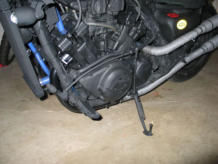

Before I start putting everything back on the bike I have a question. This 83 has running boards and what I think you guys refer to as forward controls. It has a reversed shift pattern so that Neutral is 1/2 click down from the top rather than 1/2 up from the bottom. With my limited terminology and no schematic, I want to know if it can be reversed. I noticed that the linkage from the shifter is in a "Top" position. (See crude, no very crude illustration) Can the linkage be rotated 90 degrees downward, thus reversing the reaction to pushing, lifting the shifter, thus reversing the shift pattern?

I think what I meant to say is not forward control but a rocker shift with a toe and heel?

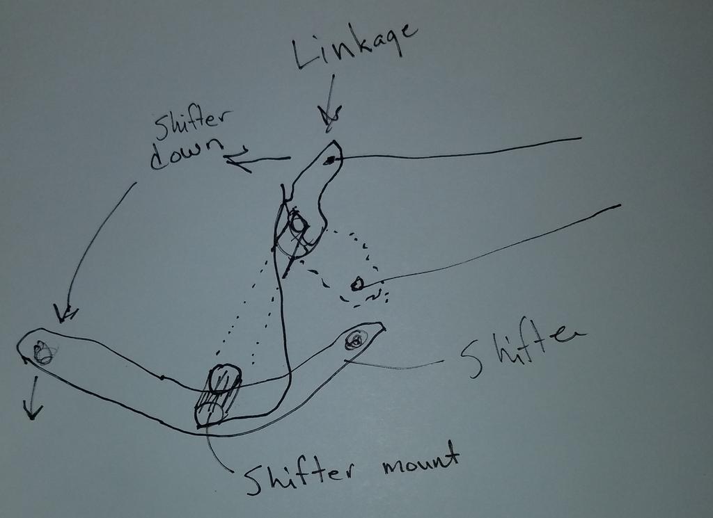

FOUND IT TY!! Hold on,, gonna thumb thru my YouTube vids and see if I didnt address some of this in one of them - thinking I may just have done that.. I will say this,, if the lever in your well engineered sketch is the one that attaches to the shift shaft sticking out of the side of the engine = for normal controls on the 1st Gen, that lever placed pointing upwards will create a 1 down, 4 up shift pattern.. Pointing downwardly, it will produce a completely opposite pattern which can be really fun to ride and have the added benefit of one of the best anti theft devices known to man!!!

But it just sticks out front and moves the shaft the same direction up and down like the stock on does. If it were upside it would be below the floorboard and you couldn't touch it with your foot at all. It'd also make a good kick stand upside down. Wierd. Nothing changes mechanically except that the toe lever is 6 inches farther forward and 2" up from the stock shifter! GRRRRR! IF all it has was the heel lever and no toe lever, then it makes perfect sense that it would be reversed.

So all that said, watched and done.. In the end you, if the internal levers are positioned as shown, you will want to make your floorboard linkage arrangement rotate that outer shaft in a clockwise manner as shown in the video when you press down on the forward shift lever (common called the toe shifter, rearward one is called the heel shifter) to create a 1 up and 4 down pattern.
Maybe this will help you understand. With the linkage pointing down, which is correct, when you pull on the lever it makes the shifter move CCW. If the lever was pointing up and you pull on it the shifter will move CW resulting in the shifter action being 180 degrees out of phase!
By changing the location of the lever by one tooth either CW or CCW will move the the toe pad either up or down...

Ok. I pick things up relatively quickly. But here's the deal, my rocker shifter mounts directly on the shaft coming out. That external linkage is gone and / so I had never seen it! You can see why the whole thing didn't make any sense without that linkage that reverses the direction of the shift action like in my dear friend Puc's video.

With all this having been said, my original question was whether THIS linkage could be rotated 90 degrees down so that that push rod rises to the rear connection rather than dropping. Again, I have not been able to see where it is actually mounted or what parts may be around it that would be in the way of such a change. I saw it move, noted plenty of clearance below the current position and imagined that it would still be higher than the exhaust so it would not be in danger of being destroyed during a high center situation. a979b63c67829afb816256b4440e6dd1.jpg

  s.tyler58 said:
With all this having been said, my original question was whether THIS linkage could be rotated 90 degrees down so that that push rod rises to the rear connection rather than dropping. Again, I have not been able to see where it is actually mounted or what parts may be around it that would be in the way of such a change. I saw it move, noted plenty of clearance below the current position and imagined that it would still be higher than the exhaust so it would not be in danger of being destroyed during a high center situation. https://uploads.tapatalk-cdn.com/20180406/a979b63c67829afb816256b4440e6dd1.jpg

BINGO!!!! Now we are cooking with possum fat!!!!!!!!!!!!!!!!!!!!!!!!!!!!!!!! Sorry Ty,,, I totally did not get that but NOW I do!!!
