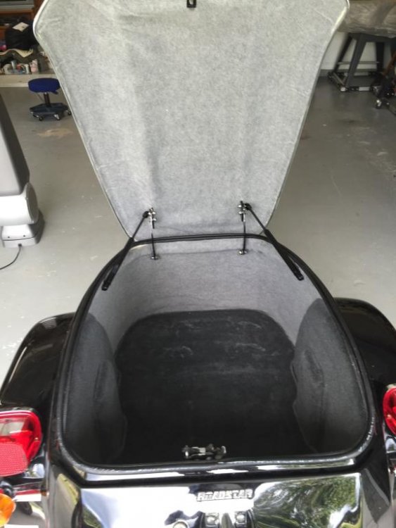

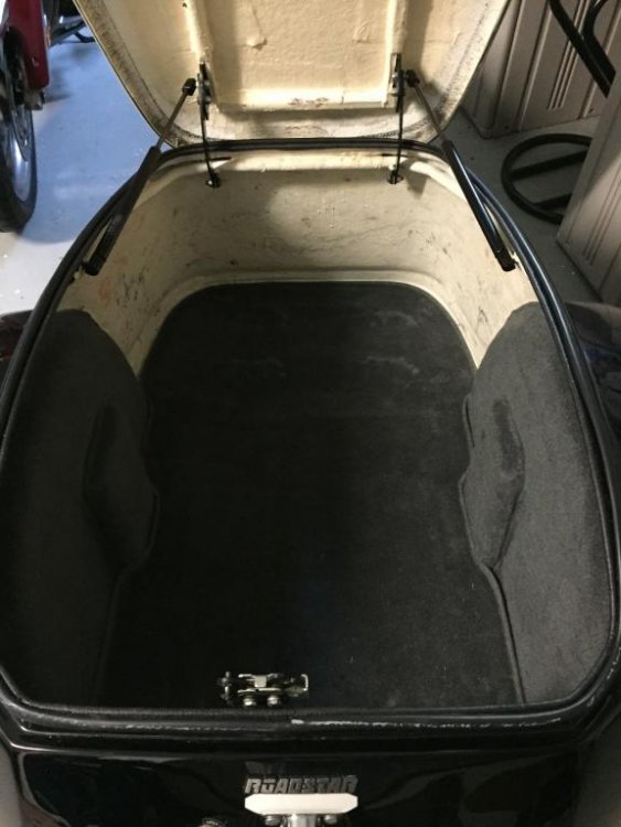

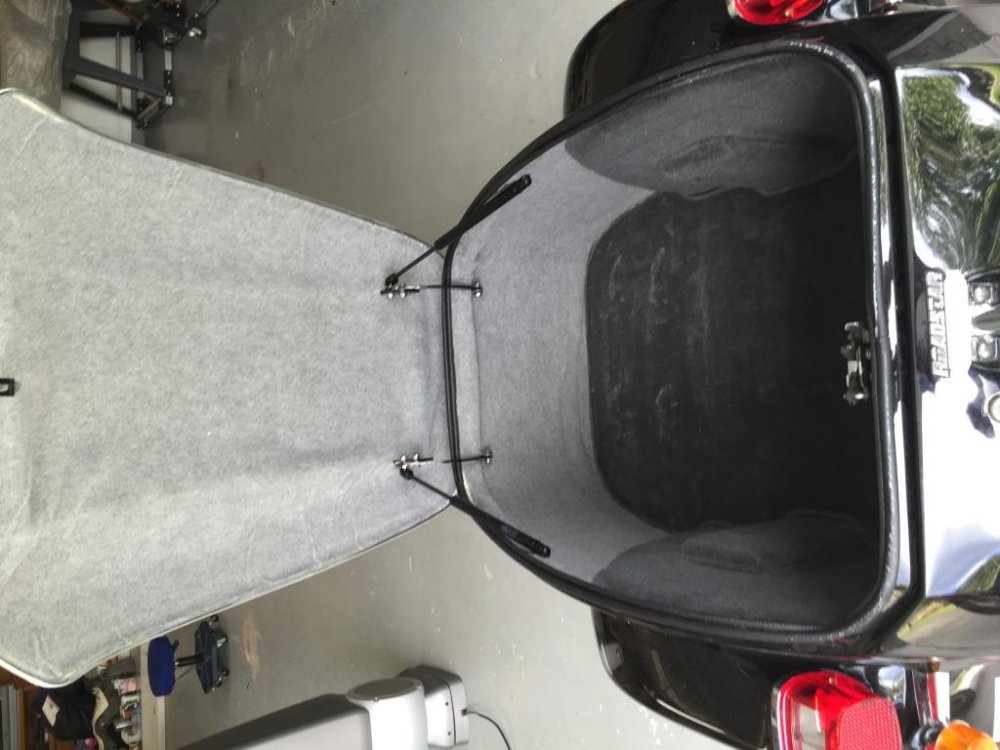

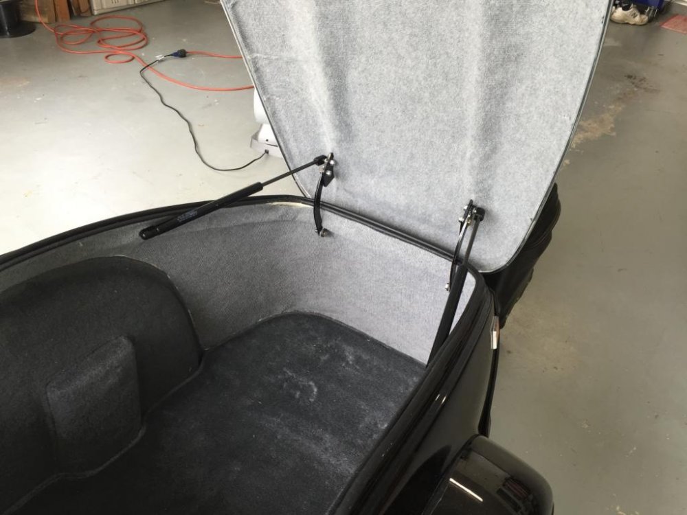

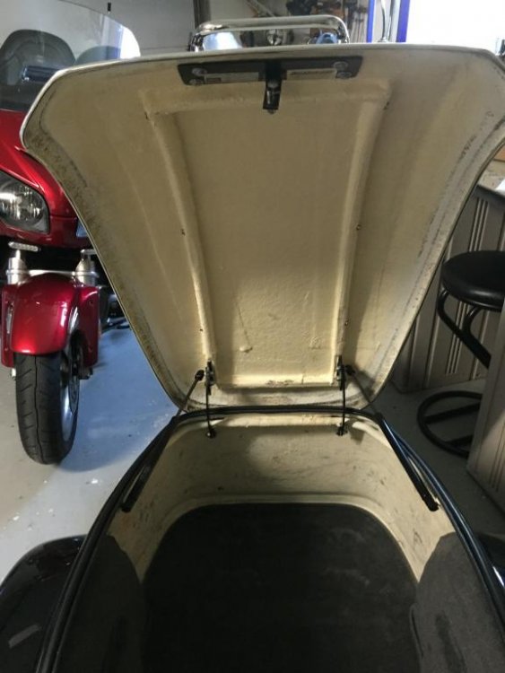

M61A1MECH Posted November 1, 2015 Author Posted November 1, 2015 (edited) Before and after pics. The Job Boss keeping an eye on things Edited November 1, 2015 by M61A1MECH
