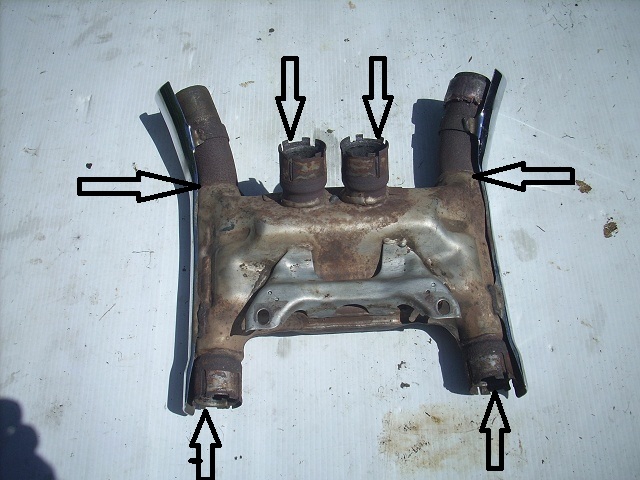

Prairiehammer Posted August 1, 2015 Posted August 1, 2015 One of the most common exhaust system failures occur at the juncture of the mild steel nipples and the stainless steel collector. Essentially the nipple rusts and cracks at the weld. The impact very likely stressed an already weak point. It is difficult to see the juncture because of the chrome heat shield. The weld joint is behind the welded on heat shield.
syscrusher Posted August 1, 2015 Author Posted August 1, 2015 So I think you're talking about the part that the fiche calls the "joint" that brings the rear pair of cylinders exhaust into the collector. It it the nipples on the bottom of that or on the upper rear of the collector? So basically I just need to remove the collector to have a look I suppose?
Prairiehammer Posted August 1, 2015 Posted August 1, 2015 Probably not the "joint" (rear header), more likely the stubs or nipples welded to the collector. But anything is possible. There are gaskets at all the points that the various exhaust components attach to each other.
syscrusher Posted August 2, 2015 Author Posted August 2, 2015 Thanks for the picture with arrows and everything! Yeah, I need to take the collector off.
