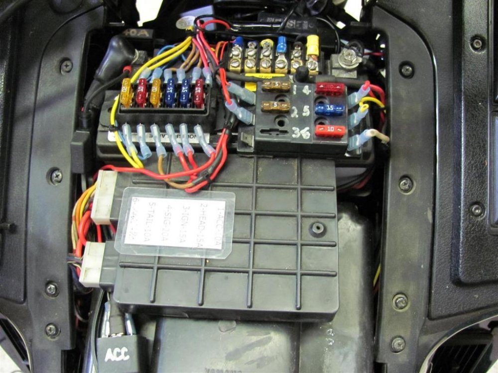

Prairiehammer Posted July 16, 2015 Posted July 16, 2015 hey don vito - how would one saw off the tabs of the TCI?? Looking into my battery box, I don't see the TCI You can't see the TCI, if the battery box and air box are in place. The TCI is under the battery box, mounted to the coil rack. I sawed the mounting ears off my TCI with a bandsaw. JUST fits under the faux tank cover, while nestled up against the battery.
garyS-NJ Posted July 16, 2015 Author Posted July 16, 2015 thanks Kevin, your pic looks like a newer bike, maybe because of the new fuse holders. I have my airbox out but can only see one TCI tab on the right side. I might be able to get a sawzall in there but there is another tab on the front or left side of the TCI which I don't see.
Prairiehammer Posted July 16, 2015 Posted July 16, 2015 While you CAN attempt to saw off the ears of the TCI while it is still mounted in the bike, I would first attempt to remove the screws holding it. Then cut off the ears. Yes, the pic is of my 1991 (newer than yours) but all the First Gen Ventures are identical under the "hood". You can do the same thing as I, to your '84. BTW: Got any tuna?
