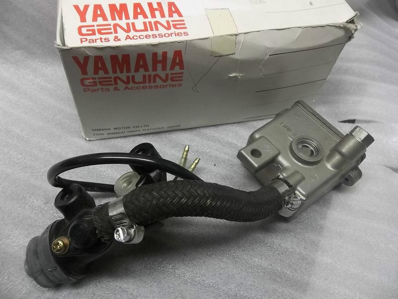

Prairiehammer Posted March 15, 2015 Posted March 15, 2015 I bought a project 83 Venture and finally got it together and got it out on the road today. Ran a bit rough at first but them more I rode it the smoother she got. I have no rear brakes. Front seem plenty strong. My question: Is there a separate brake reservior for the rear brake on the 83. I looked through an online owners manual and didn't find the info I needed. If it shares the same as the front - any ideas on what needs to be done to get rear brakes? I'll try to post a picture. Indeed there is a rear brake master cylinder AND reservoir. This assembly is located immediately above the brake pedal pivot, behind a black plastic cover held with two screws. Apparently, you are not aware that the Venture has a "linked" brake system. Depressing the "rear" brake pedal acts on the rear brake caliper AND the left front brake caliper. A complete flushing and cleaning of the entire brake system is probably in order. Old brake fluid tends to crystallize and/or gel. This degradation plays havoc with master cylinders, calipers, metering valve and proportioning valve; all devices with small (sometimes TINY) orifices that become plugged with the crystallized brake fluid.
Godlover Posted March 15, 2015 Author Posted March 15, 2015 Indeed there is a rear brake master cylinder AND reservoir. [ATTACH=CONFIG]98104[/ATTACH] This assembly is located immediately above the brake pedal pivot, behind a black plastic cover held with two screws. Apparently, you are not aware that the Venture has a "linked" brake system. Depressing the "rear" brake pedal acts on the rear brake caliper AND the left front brake caliper. A complete flushing and cleaning of the entire brake system is probably in order. Old brake fluid tends to crystallize and/or gel. This degradation plays havoc with master cylinders, calipers, metering valve and proportioning valve; all devices with small (sometimes TINY) orifices that become plugged with the crystallized brake fluid. Thanks I will have to look into it this week!
