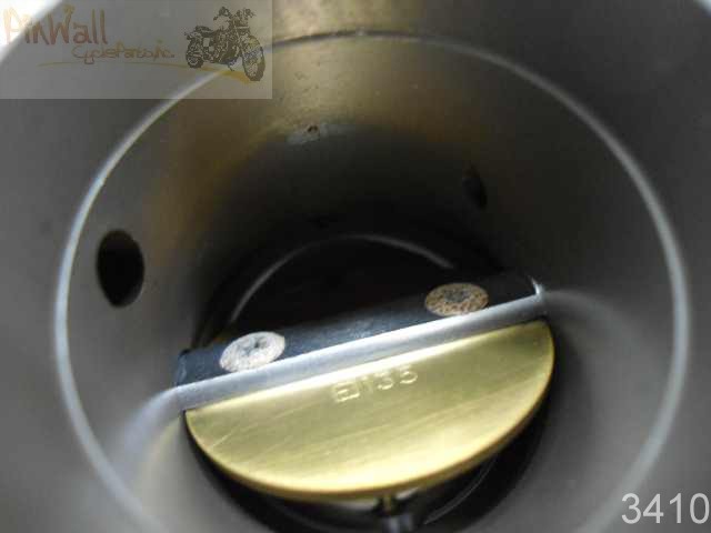

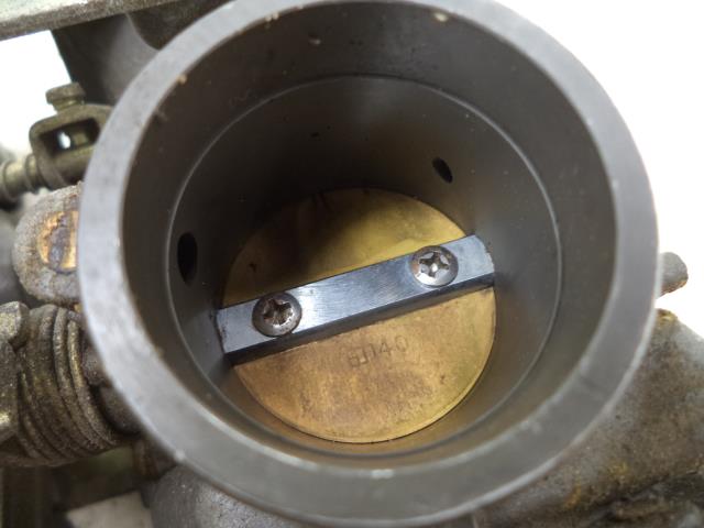

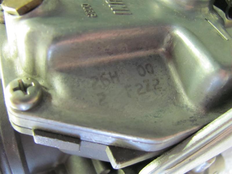

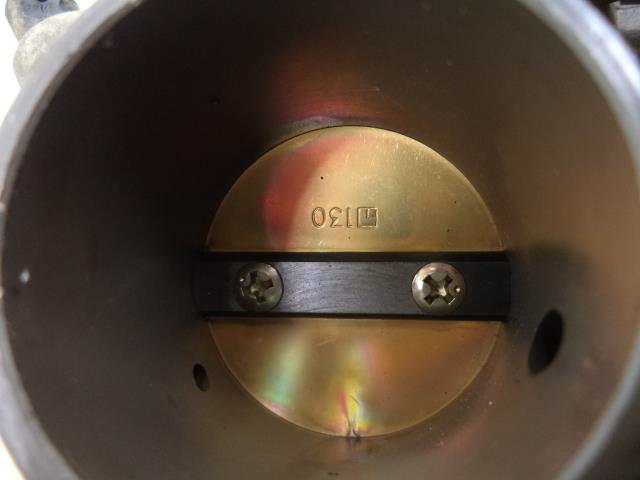

Prairiehammer Posted February 11, 2015 #13 Posted February 11, 2015 MiCarl said: The 83-85 carburetors should have an ID mark on the body of 41R00. The 1983 carbs will be marked with an inked stamp on the float bowl as "26H" mralex714 said: I should have been more specific. I am having trouble with my carbs http://www.venturerider.org/forum/first-generation-venture-tech-talk/96821-carb-trouble.html. I have another set that I am not sure if they are from a MK1 or MK2. So what specifically would I be looking for to tell the difference? The 1983 carb butterflies will have "135" stamped on them. The 1984 carb butterflies will have "140" stamped. The 1986-1993 carb butterflies will have "130" stamped on the butterflies.
