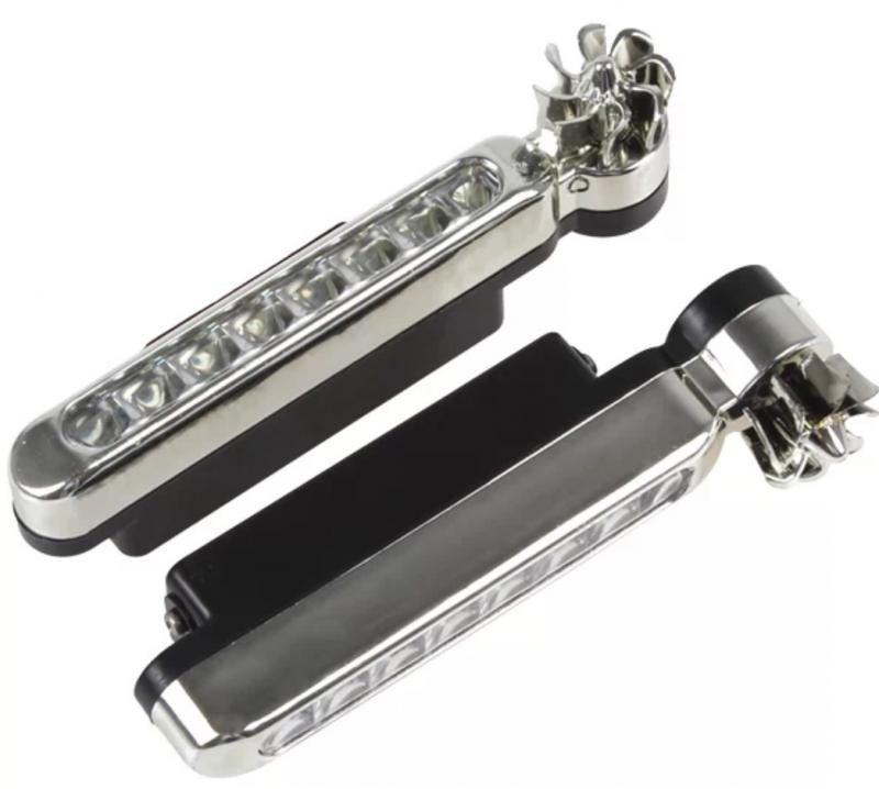

spear Posted January 8, 2015 Author Posted January 8, 2015 (edited) There's been a fair bit of PM banter backwards and forwards between me and Dion (djh3) and I thank him for his help, suggestions and offer. I've elected to go another way with my DRLs, by going 'wireless'. Intrigued? I've found COB LED DRLs that have a small wind turbine and generator fitted, and illuminate once the bike hits 30mph. Once they arrive and are fitted, I'll report back. So many possibilities. If they are okay I'm going to fit a couple to the roof racks on my camper van. I'll eventually post a link to the eBay vendor. Edited January 8, 2015 by spear Added photo
djh3 Posted January 9, 2015 Posted January 9, 2015 Interesting idea for sure. As I mentioned in our corrispondence, it will be interesting if the lights will work at in town traffic where you really need to be seen. Also turbulence behind a vehicle may be a factor. You wil have to make sure they go somewhere that keeps airflow.
