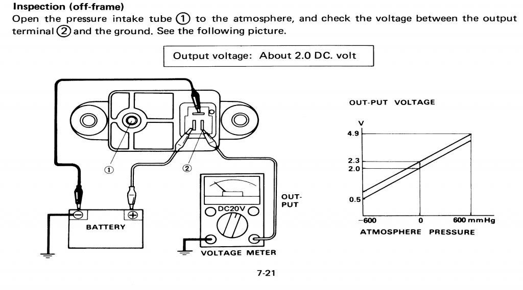

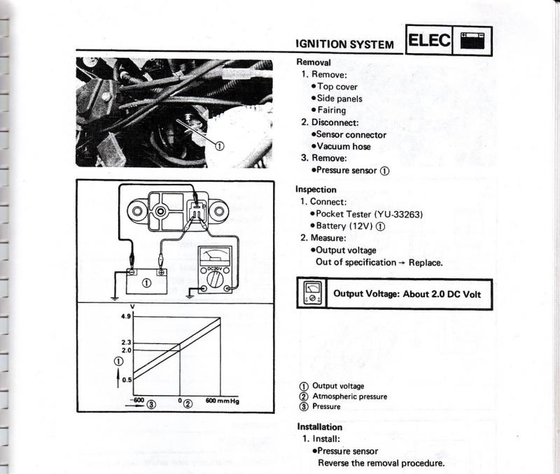

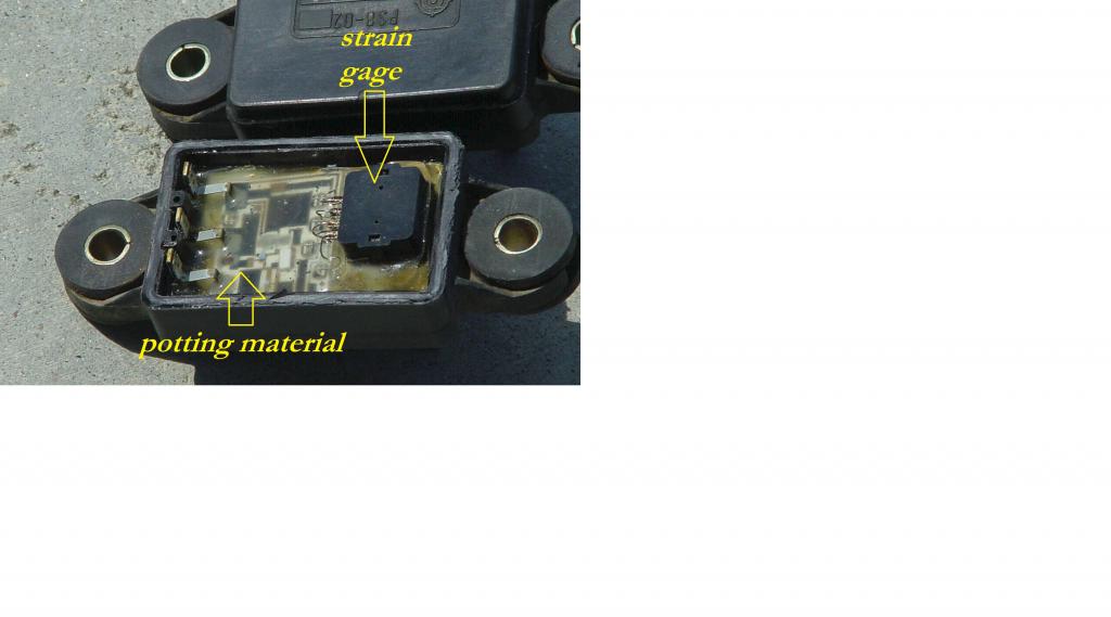

Prairiehammer Posted August 2, 2015 Posted August 2, 2015 (edited) ... but the volts stay at about 2V from 0 to as much pressure I can create. I hope you were not applying "as much as I can create" POSITIVE pressure to the Boost Sensor. The Boost Sensor should show a voltage change when 600mm Hg (mercury) NEGATIVE pressure (vacuum) is applied and 600mm Hg positive pressure. Six hundred mm of mercury translates to about 11 psi. Too much positive pressure will damage the Boost Sensor. Six hundred mm of HG vacuum applied should indicate .5 volts. Six hundred mm Hg positive pressure should measure 4.9 volts on a good sensor. Double check the procedure described in the manual. Confirm that you are checking the voltage properly. And make sure your digital voltmeter is set at the lowest range. The Boost Sensor contains a strain gage/gauge. A strain gage is a device whose electrical resistance varies in proportion to the amount of strain in the device. In this case, the "strain" is the movement of the diaphragm within the Boost Sensor, movement caused by the varying vacuum applied to it. Strain gages are very sensitive to varying pressures and to electrical over currents. It is entirely possible to "burn out" a strain gage. There is also an amplifying circuit within the Boost Sensor. It too can be defective. Edited August 2, 2015 by Prairiehammer

Vonwolf Posted August 2, 2015 Posted August 2, 2015 (edited) Sorry bad terms used, I applied as much negative pressure as my break bleeder could produce, not that much around 2.3 in.HG. The big thing is I start out at 2 volts and it didn't move from there and when I plug it in at idle the RPM jumps right away so I am apparently getting 2 v of advance right off the bat, but nothing changes from there. I was following the manual procedure as best I could, but I can't make very much vacuum I think it was enough to show a problem, but I'm not sure. ** I just noticed my "break Bleeder" is a Mighty Vac so I guess we are all on the same page Edited August 2, 2015 by Vonwolf
