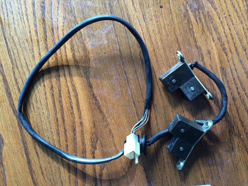

bongobobny Posted November 1, 2014 Posted November 1, 2014 The issue may be the timing pick up coils going bad, or corrosion on the connector for them. Start with an ohms test on them at the connector. The issue could be the TCI going bad as well...
H2O Posted November 1, 2014 Author Posted November 1, 2014 The issue may be the timing pick up coils going bad, or corrosion on the connector for them. Start with an ohms test on them at the connector. The issue could be the TCI going bad as well... Okay. I know what and where the TCI is. Are the "timing pick up coils" the same 4 coils that the plug wires originate from below the battery?
H2O Posted November 1, 2014 Author Posted November 1, 2014 The issue may be the timing pick up coils going bad, or corrosion on the connector for them. Start with an ohms test on them at the connector. The issue could be the TCI going bad as well... Okay, I found a service manual on line. I'll start there and see what develops. Thanks!!
Prairiehammer Posted November 1, 2014 Posted November 1, 2014 Okay. I know what and where the TCI is. Are the "timing pick up coils" the same 4 coils that the plug wires originate from below the battery? The pick-up coils are located in the stator cover, where they pickup pulses from the rotating rotor. Those signals are sent to the TCI. The four coils that are located under the battery (and over the TCI) are ignition coils.

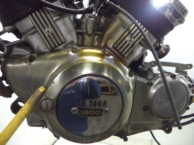

H2O Posted November 1, 2014 Author Posted November 1, 2014 Okay, I read (in the service manual) that the pickup coils are behind the crankshaft cover on the right side. I removed the large cover right next to the rear brake pedal and I'm seeing what looks like a large flywheel, but no coils. Is there more to disassemble here or have I opened the wrong cover? lol The pics I'm seeing on line are really dark and just about useless.
Prairiehammer Posted November 1, 2014 Posted November 1, 2014 (edited) Okay, I read (in the service manual) that the pickup coils are behind the crankshaft cover on the right side. I removed the large cover right next to the rear brake pedal and I'm seeing what looks like a large flywheel, but no coils. Is there more to disassemble here or have I opened the wrong cover? lol The pics I'm seeing on line are really dark and just about useless. The pickup coils are in the stator cover, the larger cover on the LEFT side of the bike. The pickup coils look like this: You apparently removed the clutch cover. Edited November 1, 2014 by Prairiehammer
