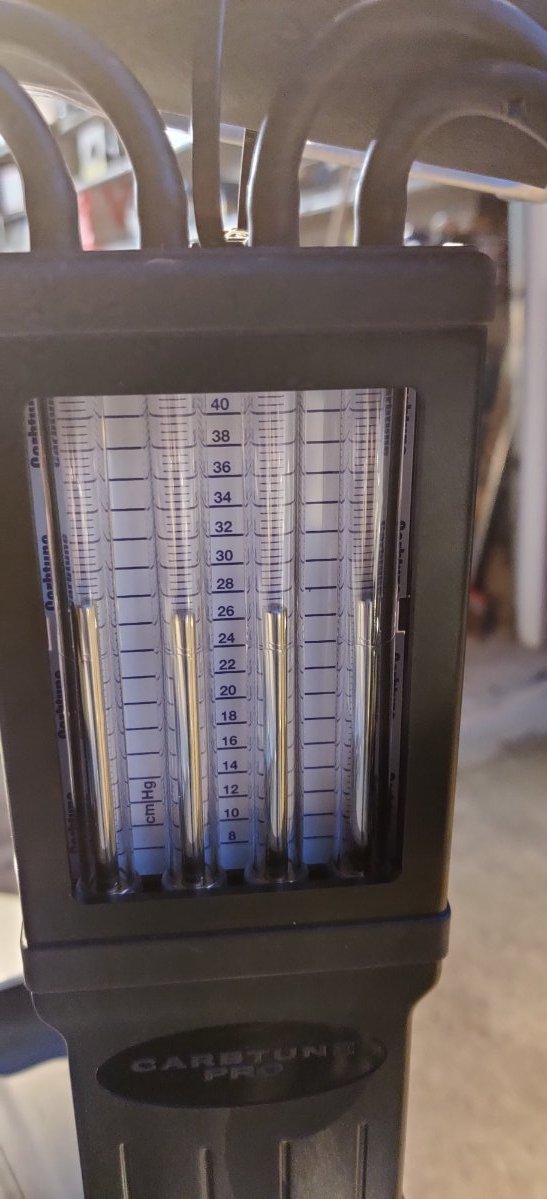

Also, the noise does not occur while riding. It starts only when the mc is idling and goes away if I turn it off and let it rest for about 15 mins.
It started when I tried to further balance the carbs (flat head screw) and really fine tune it.  This noise starts when the idling goes down while tuning the carbs. I'm just not sure what is causing it.
Edited by megablok
