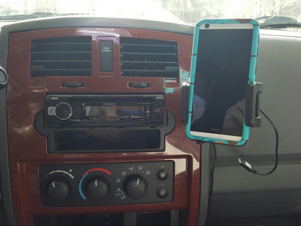

2005 Dodge Dakota. Installed Kenwood KDC-BT365U. Also cell phone holder installed near radio head.
I had very bad FM tuner interference after 1st install, to the point that auto tuning could not find any channels, and manual tuning to known good channels finds the stations but very broken and noisy.
I opened the dash back up thinking I had damaged the antenna connector.( When I removed connector from the OE radio, I had to pry it out). I did not see any damage to the antenna connector or the dodge to Motorola antenna adapter. Even so, I cut off the dodge connector from the coax, and directly installed a replacement Motorola connector on the coax for a direct fit without adapter to the new Kenwood.
Putting dash back together and had the same issue. Taking it back apart again while the radio was playing, I found the issue. The cell phone, when plugged up to the charger, is causing the problem. This problem did not exist with the OE radio/cell in the same configuration.
I found I still have the interference even with the cell in the lap, so relocation is not a practical option. I also tried 2 different cells, HTC and Note5, and same issue.

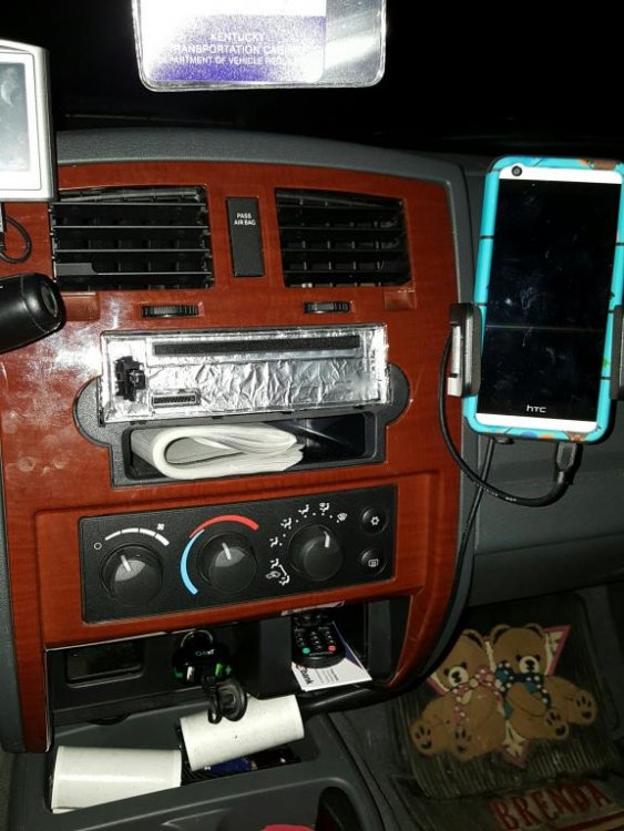

After much experimentation, I have reduce to problem by moving the phone charger from the dash power receptacle to the rear of center counsel power receptacle, leaving the phone at the original mount location near the radio head. Still some interference. I even wrapped aluminum foil under the removable face plate to the radio chassis attempting to provide front shielding. Call to BestBuy and tech stated that all after market radios have less shielding than OE radios. No sure that I believe this statement. Call to Crutchfield did not offer any suggestions.
I am not sure what else I can try. I am very suspicious that the problem is primarily due to this specific model, or maybe just this specific serial number of the Kenwood radio, but I am leery to return it to the store, purchase another radio of same or different type/brand and have the same issue.
I am also considering getting on of those cheap antenna "pre-amp's" with the thought that the higher power antenna signal into the radio will overpower the interference it is experiencing, but everyone I speak with says these things are just junk, and don't really do anything.
Any ideas or suggestions of a different radio to try.
The Dakota OE is 1-1/2 DIN, although I have read that some have fitted a 2 DIN with custom cutting, I am not sure I want to cut the dash up, but may consider it. I currently have a 1 DIN dash adapter that fits good. Feature Requirement is FM, CD, USB/AUX, Bluetooth Hands-free for at least 1 phone. Additional would like would be BT for 2 phones, GPS NAV, backup camera..

Thanks Video,
I have already tried shielding. I wrapped foil around chassis and front end behind removable faceplate. When I completely wrapped the cell, (ungrounded) it made the problem 10x worse.
So far the best solution has been using the rear power port, but looking for recommendation of a better radio. Looking at specs for the Kenwood, it has FM sensitivity of 8.2dbf. Unless this radio is defective it is low enough there should not be a issue. A preamp would probably overload the front end. Maybe an attenuator would make it less sensitive to the cell interference, but then likely not pick up FM. I'm stuck
