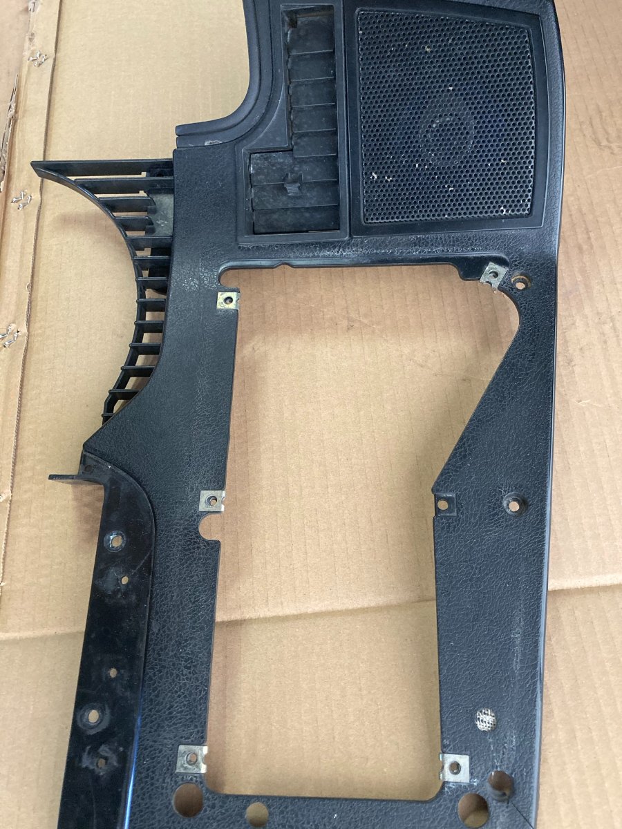

I was thinking about upgrading my sound system and was wondering what options people might know about. I really want to keep the stock console in place simply because it looks like it belongs. Every aftermarket stereo looks obviously like that. I really only listen to music or maybe starlight radio via my cell phone so all I need is something that can wirelessly connect to my phone. I was thinking maybe someone makes a unit that mounts out of site with not requiring a dash mounting. The other option would be to upgrade the amplifier since it is a stand alone unit. I have replaced the speakers twice now it has not helped enough. I also considered getting a set of rear speakers off an old Kawasaki Voyager. I think they sit right in the luggage rack. Four speakers would help but more watts will likely be required.

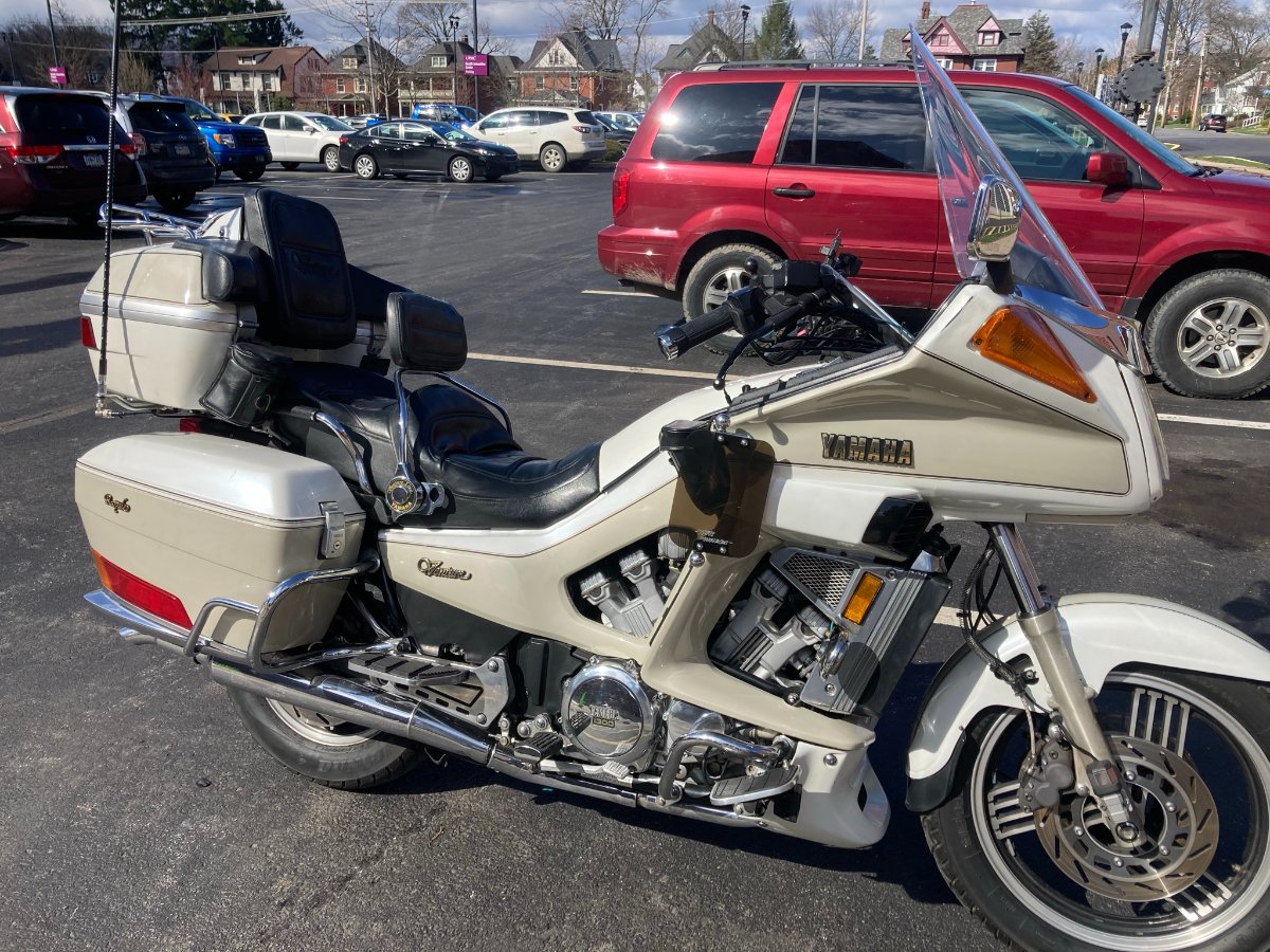

Not sure where I left off with the posts about this winters rebuilding but here are some of the photos. I ended up refinishing many old clear coated parts and a lot of plastic damage. A lot of epoxy and fiberglass. Put on some small 2 inch driving lights under the highway boards that worked great ($20 from Napa). Did not paint anything since the damage was so minor. Just had to replace the radiator hose from the thermostat housing to the radiator. The Advanced Auto part number A71651 worked perfectly after cutting off an inch. I still have a cold night drip that I cannot find but it is a small amount and I really have no idea what to change next. I found a new thermostat housing and o rings that I must have purchased some time ago. I think someone said that might be the problem but I have still never done the replacement since it requires some significant disassembly to get to it. I am very happy with the way the new finish on the metal parts looks. I don't think the bike has looked this good in 10 years. Looks like I will be keeping it even though we are getting a new 2018 gold wing later this month. That one is for the wife. The Venture is too top heavy for her taste. Oh ya, the original problem of an oil leak and low voltage has been corrected with the new parts and probably a little copper washer.

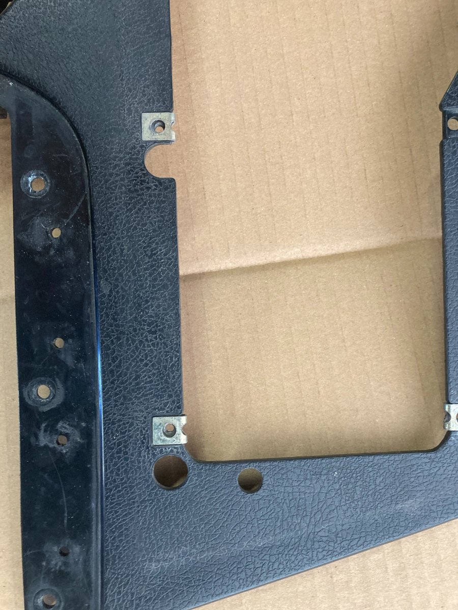

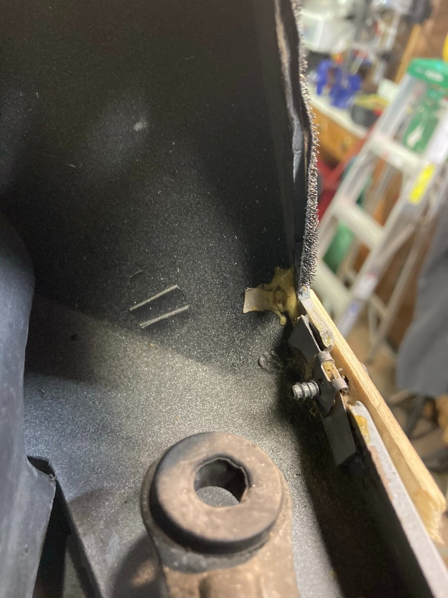

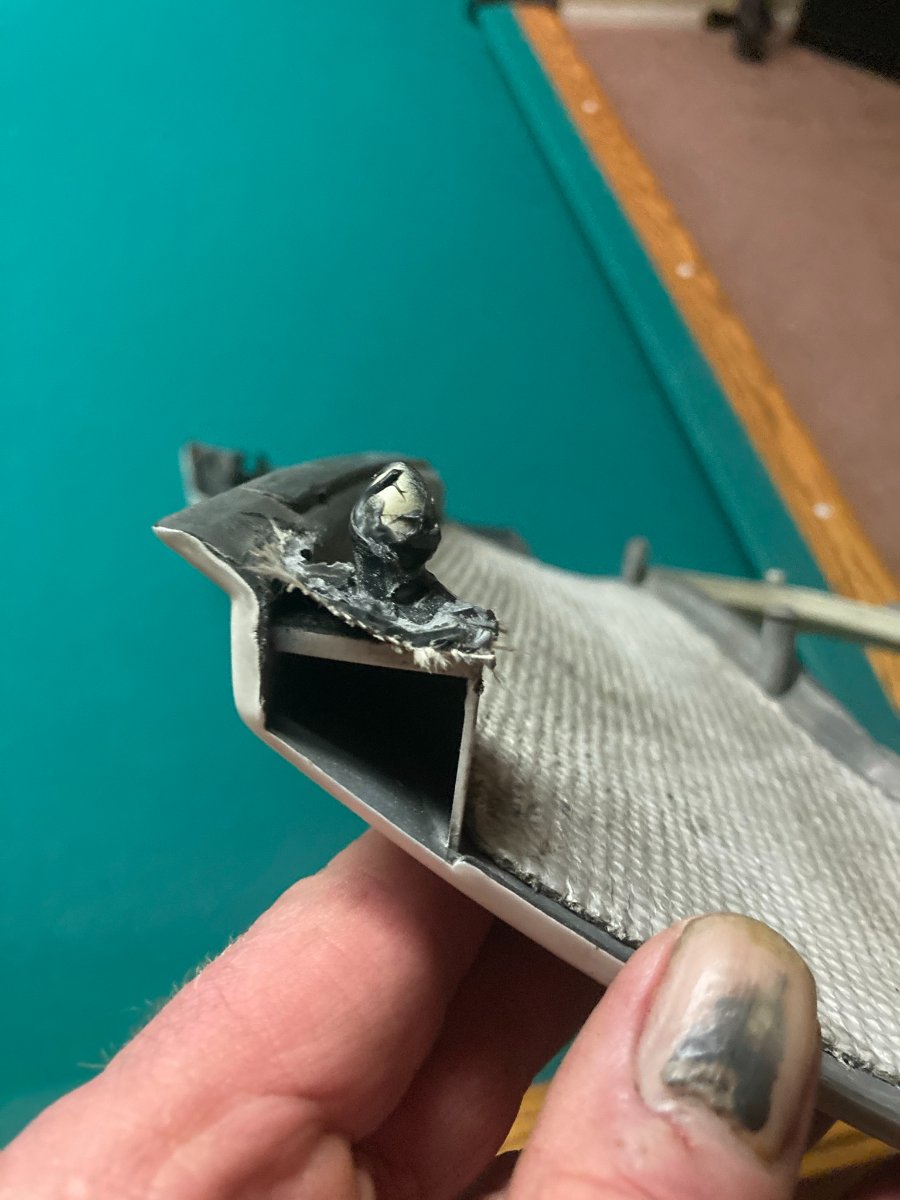

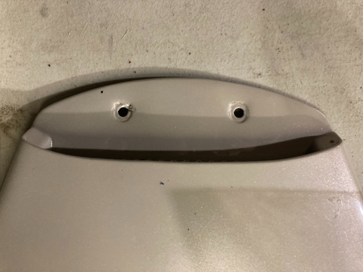

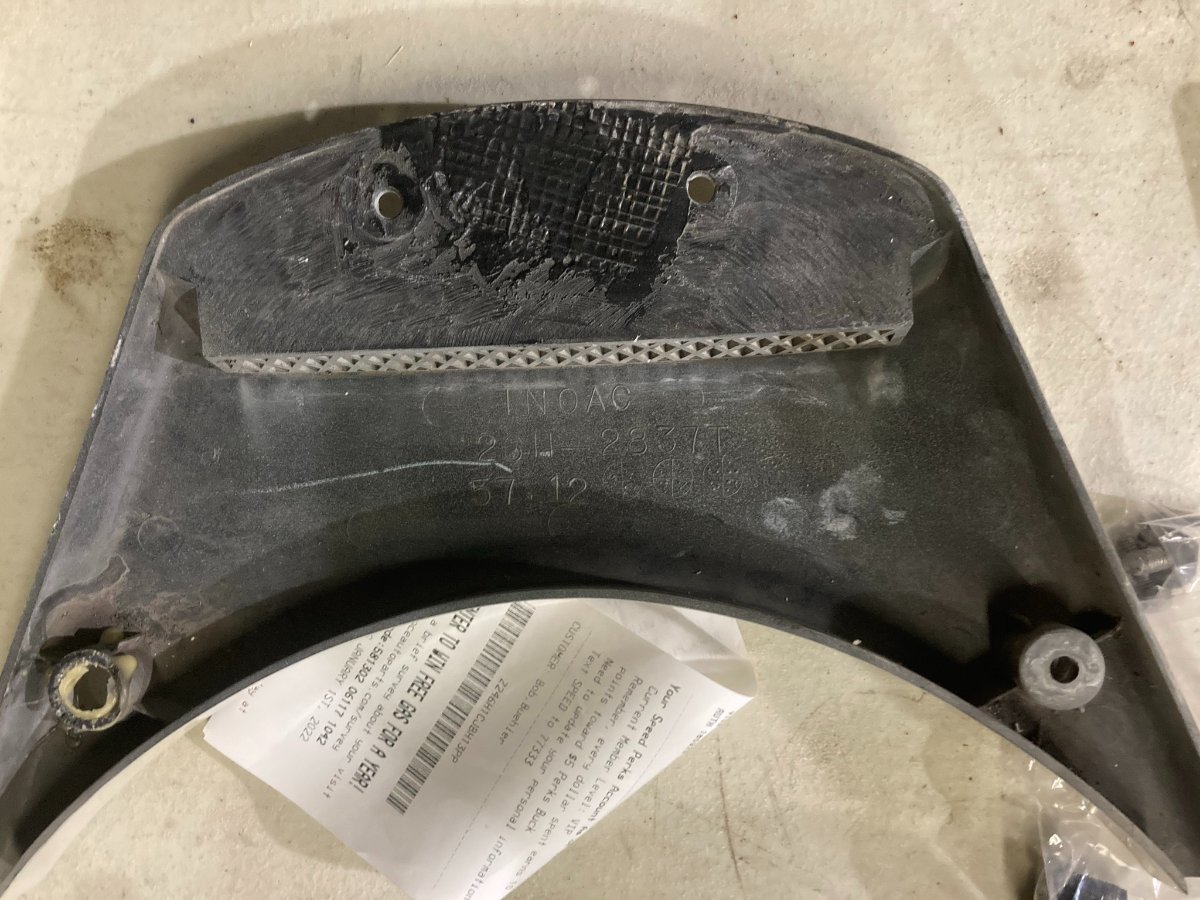

Got close to putting the last parts on and found an old repair had failed. My headlight cover had one of the fastening locations repaired with a small section of sheet metal glued to the back of the plastic with the clip on it. Decided to go with epoxy this time instead of the Gorilla glue. Sanded the plastic back side and bead blasted the metal. We will have to see if it holds. I thought the clamping of the glued part in place was rather cleaver. There are a lot of plastic repairs on this bike. Maybe a backing of more epoxy and fiberglass would help this one stay in place -

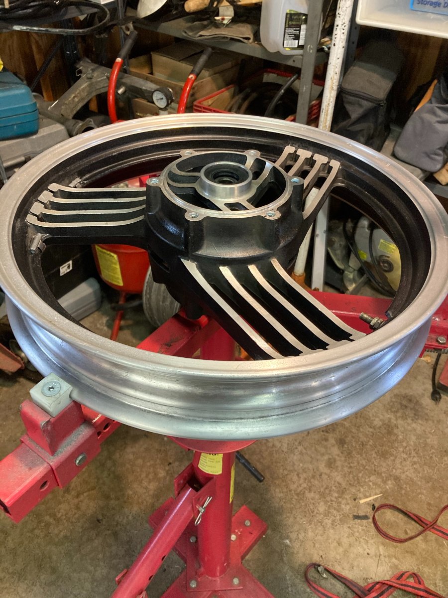

You are definetly getting down to the details. I did see one that had all the lettering on the dash redone. It looked good and really made them look brand new. I made some progress over the last few weeks but also slow. I have had a nagging air leak on the front tire probably ever since the local shop put the tire on. I have always changed my own tires but thought I would give the shop some work. It ended up costing $200 by the time I was done and it was apparent that they did not clean up the rim before putting the tire on. I have always done that and never had a tire leak around the rim. This one was and the rim was a mess. It was probably a little more of a mess because I tired so fix a flat out of desperation last summer. I spent a little time and cleaned it up to a really nice shinny finish and so far no leaks. I also bead blasted the rotor bolts and took them to the wire wheel before putting them back on. I am finally getting close. Put a new head light plug after buying a new pair of lights from Supperbright. Turns out I did not need a new light let alone a pair. I just needed a new plug. I also wired up a pair of 2 inch led running lights. I will have to send some photos of that. They fit under the highway pegs/boards nicely. -

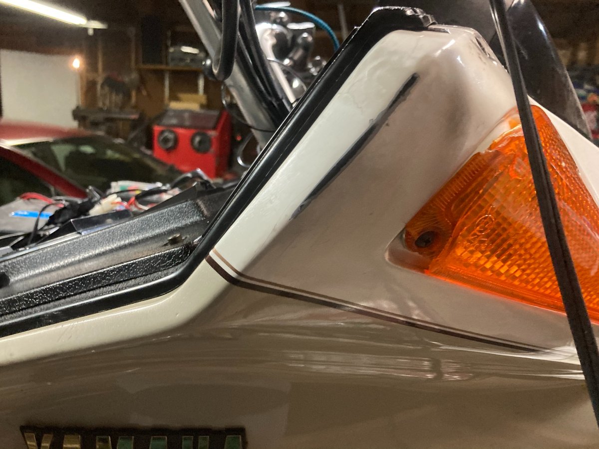

Really, that is uprising. I would have never guessed that Yamaha made them for trim. They so obviously serve to hide the inevitable fairing damage if the bike falls over. I look at it like the mirror placement that eventually found it place to shield the hands. This bike falls over and hits the engine guard and then just keeps going until it ends up on that point of the fairing. The amount of damage that occurs is like the old bumper on my 71 mustang. I can probably identify 12-24 plastic fastener points that potentially crack from dropping the bike at parking lot speeds. Just poor engineering. Maybe Yamaha realized this and made the edges to help cover up the problem.
Does anyone know where you can buy the chrome edge trim that goes under the mirror. Yes I have a damaged edge that needs covered. I have seen them on bike but never for sale.

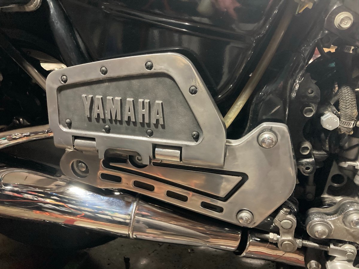

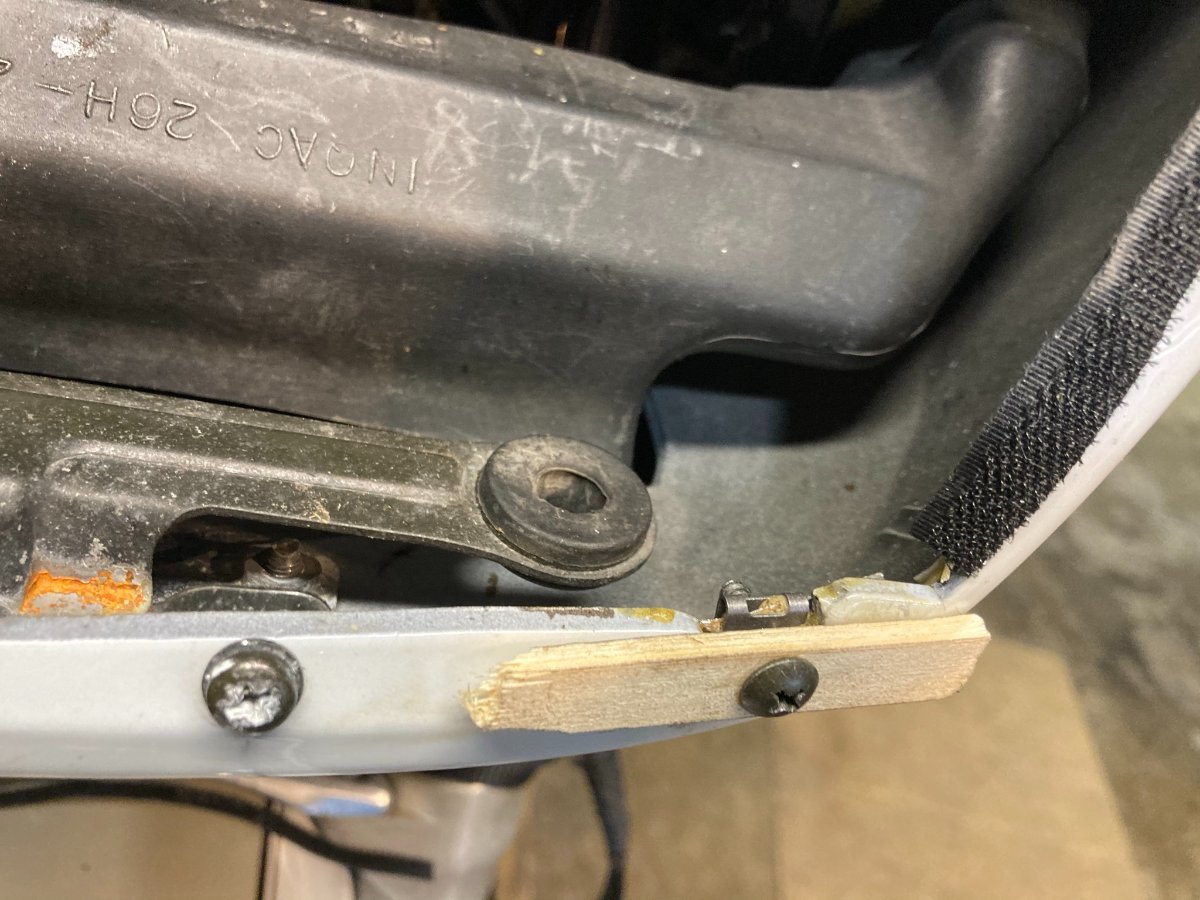

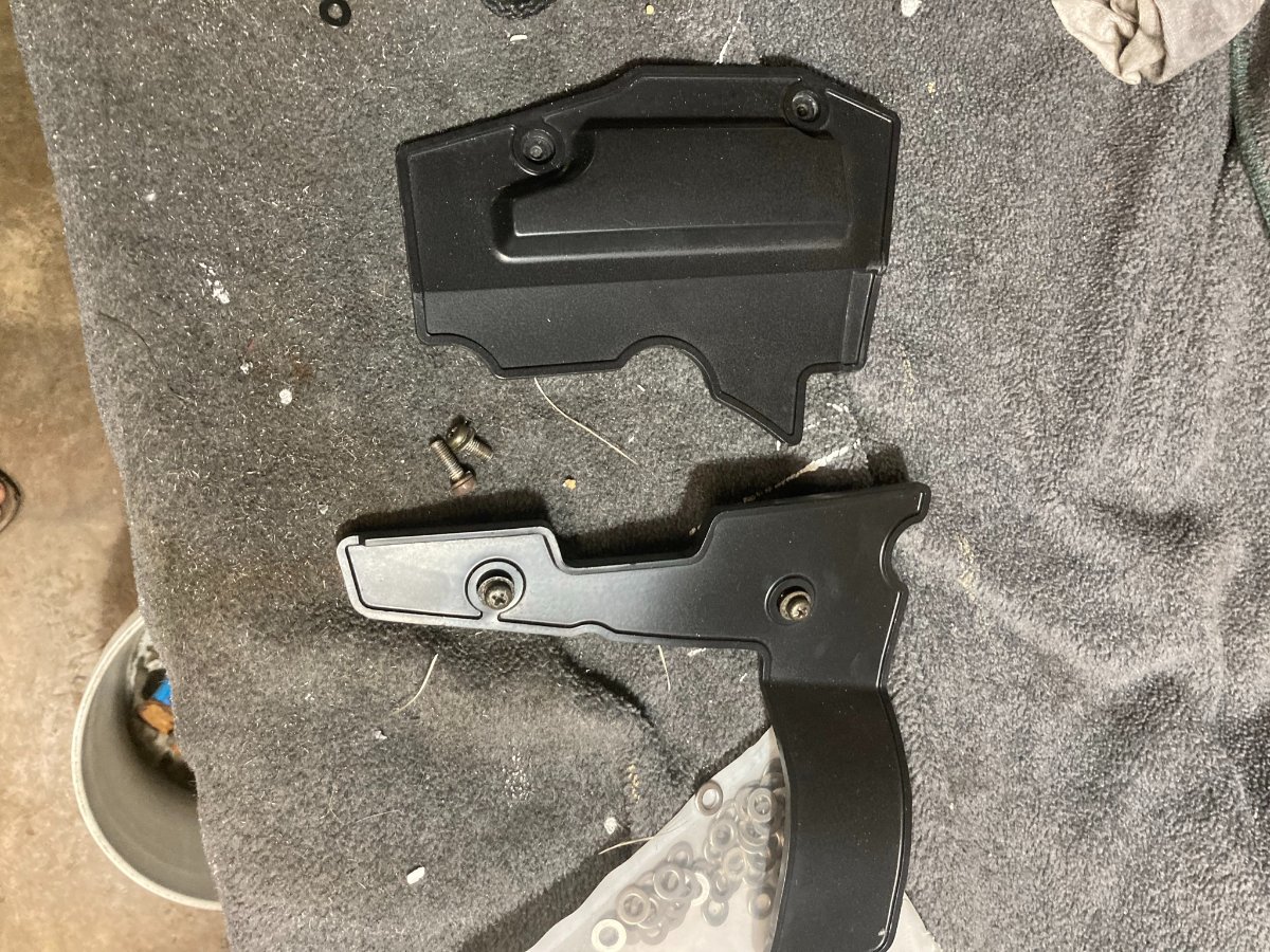

Don't ask me why after 10 mg of zolpiden/ambian and a couple of oz of run I would want to share what I managed to get to get done today. Please excuse the pile of photos, they all dumped in at once as zip file from Icloud photos. I will try and explain what each photo documents The first shows how I glued one of the pins back on. I have done this before but it did not last. This time I wrapped some fiberglass around the epoxy and later sanded things down to a better shape. I think of it as bandaid. The next is just a shot of the oil filter cover after sand blasting and painting, then a coat of black paint on the black plastic covers. I put some velcro behind the headlight cover since something is missing that keeps it snug. A body man and painter made some other repairs about 6 years ago that are holding up well. He did the same thing with epoxy and fiberglass. So far I have had good results with the fiberglass backing on the epoxy. Pretty much everywhere I have just used the epoxy the repair eventually failed. I dropped the bike a couple of years ago and got the upper fairing damage that is so prevalent on most bikes. I repaired all of the contact points and sanded this scratch down for the painter. As I mentioned the painting was so expensive that I decided to leave it. I am now looking for the chrome corner covers you see on most of these bikes. The saddle bag cover finally flew off a year ago but fortunately it only got superficial scratches. As with the fairing it was just too expensive to repaint. I may sand the scratchs down with some 1000 or 1500 paper but only rubbed them out for now. I guess I am scared to take sand paper to the painted surface even if its very fine grit. The one larger repair on the fairing that might show is going to get some fingernail polish. The painter suggested that pearl white is difficult to paint and expensive so he often recommends shopping for touch up paint in the drugstore. I got most of the clear coated parts off and polished. While I really like the black paint job that John is doing, since I am not painting the block that option would not look right. I had to repair many of the holes in the dash panel on the right side since the crashes over the years have opened all of them up. I did the same thing with the epoxy backed up by a small section of fiberglass. I tried to level off the glue in the holes with super glue but it did not work as good as I would have liked. Looking at it now I think it could have just leveled the holes off with epoxy and drilled them down a ways and then put the mounting hole right down the center. I don't ever expect to find the caps that went in the holes but I am not that concerned. Hopefully today I get time to put the left side dash back together and mount up some running lights. I would love to get it all back together today but I suspect that is just wishful thinking. Especially on Valentines day. -

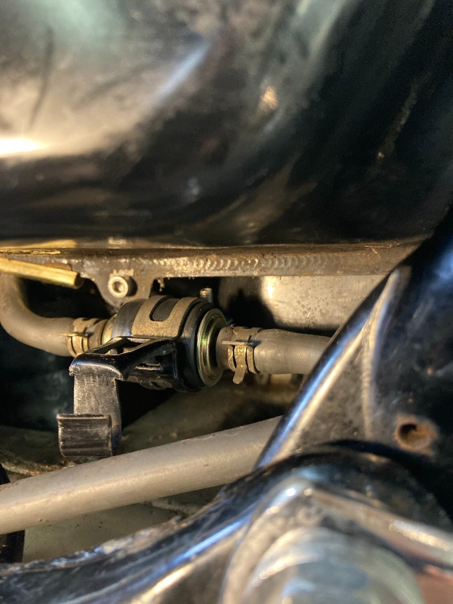

Who ever said the fuel filter was best ordered from Yamaha might be right. I have now tried two different ones that were cross referenced to the correct ones and both were the wrong size. I made the second one work with some rubber hose and electrical tape. The first one was too big to fit into the clamp. I suspect the clamp is not really needed but at least this one is in the clamp. I assume it will flow enough. -

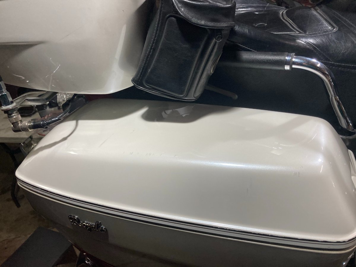

Bad news from the painter. The one faring panel and one saddle bag lid needed touched up. Well there is no such thing as touching up. The two parts were going to cost 7-8 hundred dollars to repaint. I said yes but then changed my mind. They were not that bad so I am passing on that expense. Money will get spent on another bike project. My Vision needs some cams -

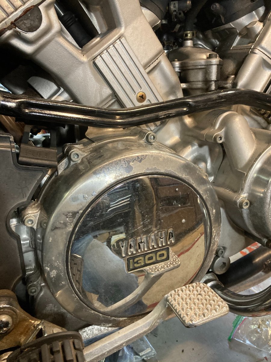

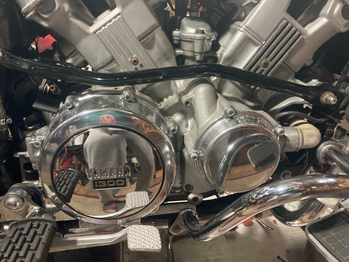

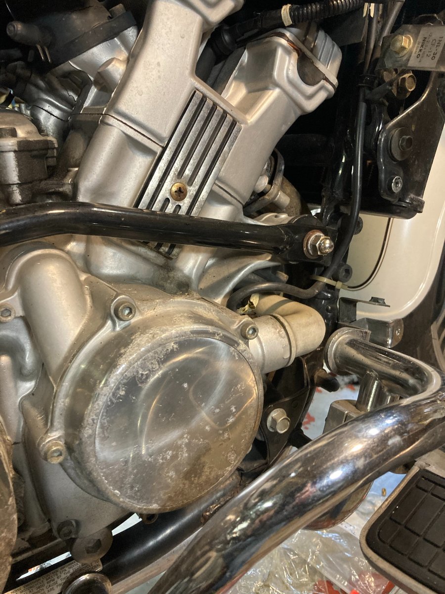

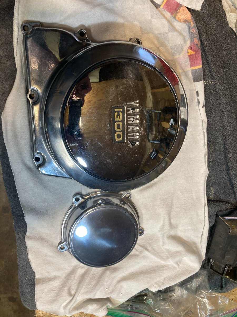

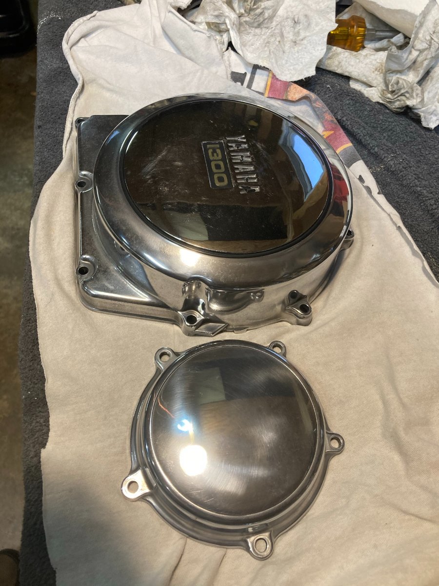

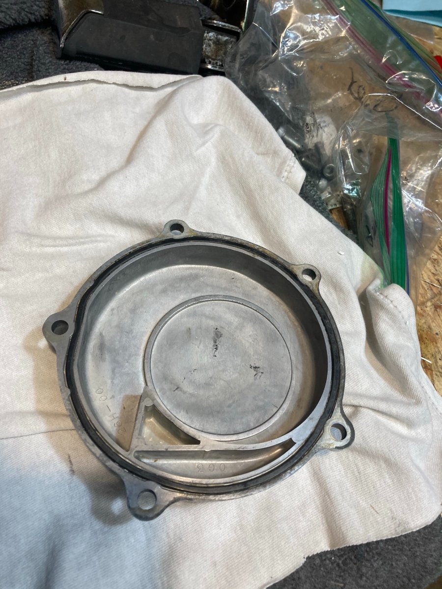

Not trying to steel hijack you thread John just thought this was a good place to talk about general restoration issues. There are so many old threads on here it gets difficult to find what you are looking for. If anyone thinks it is best to start a new thread or put these photos someplace else just let me know. So I got motivated today to make something look better and pulled the clutch and water pump cover. The photos show a before and after cleanup. I learned two things today. That fancy chrome plate in the middle of the clutch cover is attached by a screw on the inside (why why why would they do this). It was really tight and required heating to get it out. Scary since there is a rubber grommet under the screw. Probably could have left it on but I was sand blasting and thought it best to remove the cover. The other thing I learned was the water pump cover does not have a gasket it has a big rubber O ring. Anyone have an idea what size that thing is. I hate to order it from Yamaha. I suspect it one can be purchased on line someplace so long as you know the specs. This bike is going to look way better than it has in a long long time. I guess i am going to have to keep it even if I don't ride it as much -
