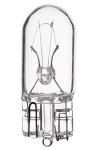

Repacing the overdrive lamp in a 2nd generation
STAR RIDER replied to STAR RIDER's topic in Watering Hole
That's right - If you can get to it!!! I did get to it using a dentist hook to remove it and pushed it back with a small long punch. I had used the tools I had. The 194 bulb lit when I was in overdrive. Job complete and thanks southbound for your help. -
Has anyone replaced the overdrive lamp on a 2nd generation Yamaha Venture. I split the fairing, but not sure if I have to remove every thing to change the bulb or pull the rubber socket out.
