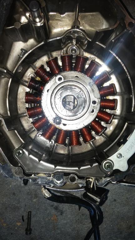

HELP! Voltage issue
RoyalRider05 replied to RoyalRider05's topic in Royal Star Venture Tech Talk ('99 - '13)
HELP! Voltage issue
Just replaced the RR and nothing...same thing. My headlamp even went out and came back on. So Stator it is! -
HELP! Voltage issue
99% sure its the stator. Its alarming when i set it for continuity to ground..... -
HELP! Voltage issue
i went ahead and ordered a new RR. everything else is checking out ok. The only part that is a little skewed is the diode test. Its reading 4.6-4.7 and not .5 or above like it should. I dont know what else to even check. 100V at 4000pm is coming out of the stator. So it looks as though the stator is OK. We shall see -
HELP! Voltage issue
OK. I will give it a try tomorrow. Its such a bummer right before a big trip! -
Hey All, SO...i am having a voltage issue and need some help. At the battery posts its reading 12.2-12.3 while the bike is idling. When i rev it, it will goto 12.5-12.6. Below i have followed ALL steps of the testing at the RR and the connections are clean and solid. I just bought a new battery. I am baffled and cant think of anything else to check. I believe the system should be putting out 14V at the battery correct? Thank you! http://www.venturers.org/Tech_Library/?action=article&cat_id=002007&id=400
