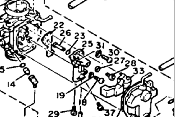

VICTORY! Well sorta. Upon inspection it appears that only ONE of the MAIN NOZZLE had o-rings. So what I did was a hack, 2 smaller o-rings out of a generic kit to try to fill the gap. You can see in other photos I'm kinda learning what they do, I installed way too fat of a ring and it doesn't fit. So looks like the last guy working on these just didn't bother with them, perhaps. Next up is the coil pack was certainly defective, and I have now by passed it. Simply cut out the old one, steal the adapter and I'm going to home it under the radio, and I will probably just do ALL coil packs. She still only starts with quickstart. But I can get her a little more quiet. I need to adjust the air/mixture screws for sure, I have a feeling they're outa whack from the last guy. I put my hand behind the exhaust and both pipes were HOT, where as last time the left pipe was half as hot. So the ignition coil was for sure a problem - you think I should replace all coils? REALLY excited that I may have it figured out today. IMG_1369.MP4

So looks like I am infact missing TWO "Washer, Main Jet" -- which explains why I'm only firing on 2 cylinders I think, because if this washer is missing the Main Nozzle will have 2mm of play and can wiggle, which changes the adjustment of the main needle by 2mm and does not properly stop fuel flow essentially flooding the entire carburator -- which also explains the back fire and woosh of smoke out of that side of the carburator! I have started replacing the ignition coils already which probably doesn't even need to be done 😕 But hey, new ignition coils are new ignition coils. Just need to find a replacement for a few washers and I think I might have a shot at riding this weekend!
